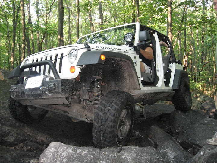

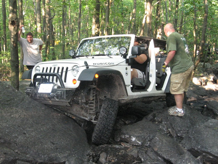

I had moved my OEM rears to the front with my Rubi and TF 2.5" Coil lift (and spacer), so I got about 3.5" inthe front. The rears were fine both with and without the spacer. When I installed 3" coils, which going from 2.5" to 3" netted me about 1.5" gain, I went with Northridge 4x4 adjustable (non quick disco) for the front and still kept my TF extended rear ones in the back and its great...
Here is a pic from when I was running the 2.5" lift and the OEM Rear links in the front with the Edisco'd.
