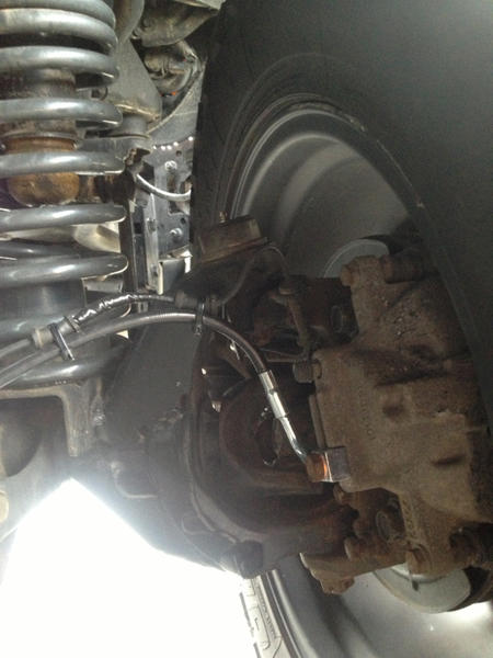

It'd be a good idea to remove the bracket and just zip tie the lines to the shocks. It's pretty common with 2.5" kits. Apparently 2012+ Jeeps have longer front brake lines than 2011- Jeeps.
Hard to see in the pic but the bracket is below the spring perch that's usually removed.

I've installed the same kit myself. I have a 2012 JK. I have noticed that if my suspension is fully extended, the brake lines seem to be a bit tight. Longer rubber lines would be advised, especially if you plan on doing any flexing of your suspension.

I have a 2011 which has the new style brake lines. I unbolted mine from the axle until I got brake lines. I got crown performance and they were longer but still bolted to the axle. I ended up just taking the bracket off after I noticed it was hanging on the bracket and tore a big chunk of the coating off the outside of the brake lines. If I did it again I'd get the ones without the bracket.
