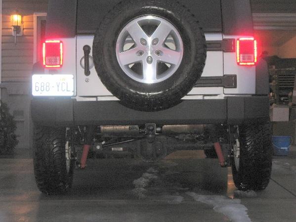

Originally Posted by brian_crystal
The consensus appears to be "depends on if you can "stand" a 1/8" off center rear end. Now, if this bracket is "mandatory" why aren't they offered as part of the 2.5" kits?
Mine came with my TF 2.5" BB and I haven't used it. Here's how the back end looks now:
If you can't tell by the pic the passenger side tire is about 1/4" further out than the driver's side.
I just ordered an adjustable JKS rear trackbar from Dave. I will post the improvement when gets here. (01/13)
