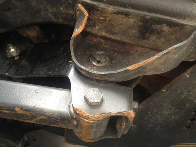

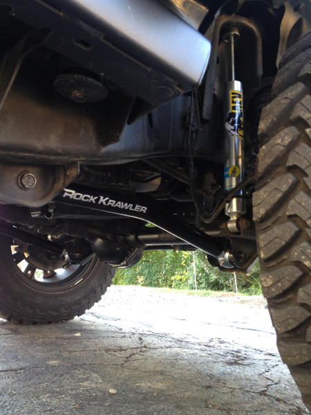

^ Agree with both of these guys. Front control arm drop brackets are great for improving on-road ride. If you ever plan to get dirty just go ahead and buy front lower adjustable control arms. It'll save you $125 in the long run.
^ before and after ^
