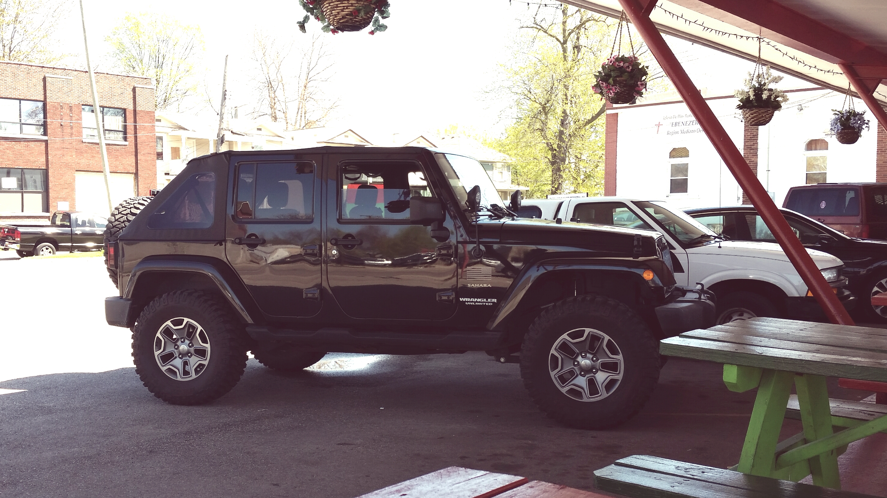

Originally Posted by Potato Potato
I'm running a TF 2.5 coil lift with shocks and have no complaints. Ride is good for a DD and I think it looks perfect with my 35s.
I considered a body lift but it didn't seem worth the risk with my 6 speed.
Post up some pics!

From lunch yesterday.
Name:	2016-05-04 07.17.06.jpg
