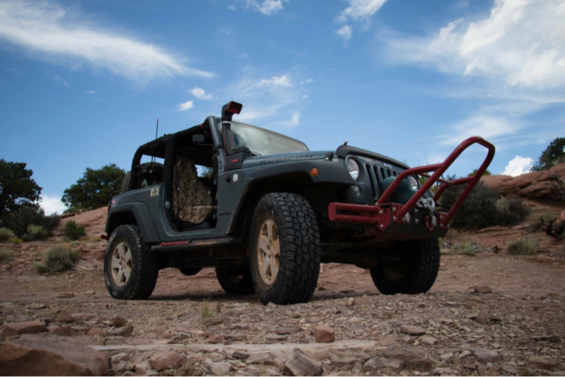

I have these but they are the xtreme's.
Also have 1-1/2" spidertrax spacers.
Fabulous tire. This pic is in Moab last September.

Perhaps I should have mentioned I have a 2-1/2" lift also

How did they measure up when installed? I'm going to pick on you because not many people run this size tire and I didn't expect a big response. I won't be running spacers, trying to avoid that and based on what i'm seeing I should be fine. I'm running a 275/70 now which is basically the same width. I've got plenty of clearance for a 35, as I could actually fit a 37 but I have no intentions of going that tall.

Spec wise they should be 34.8"
On the ground at 35psi they measure 34"
I had them down to 10 psi in Moab and they performed excellent.
I actually got comments on them from the die hard duratrac guys.
I have 1.5" spacers NOT 2" like I said and with the sway bar disconnected and at full lock I get a little rubbing of the tire on the sway bar.
I like the narrower tire as it allows the tire to go up into the fender flare at full flex.
These tires run nice on the highway but are also very capable off road.
I recommend them to anyone that will listen
