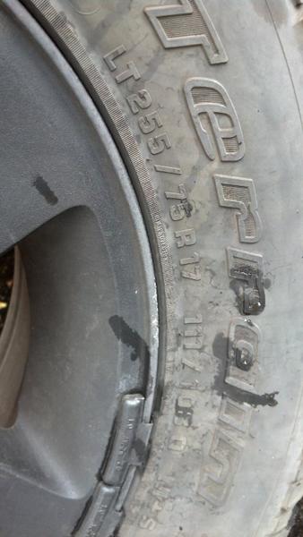

Nope same height, yeah they are 32's like mine just a bigger rim well one inch

how do i measure a tire then?? cause when i masure i get a mear 30 pissn inches??
maybe litle over? my tires prob still have 30% tread..., could that b a hieght factor. o well, so i know thier "32s", thx

The sidewall is approx 7" (70% of 255mm)
The rim is 18"
18"+7"+7"=32"
Hope this helps
You are measuring with a tape measure that may or may not be level, the air might be low in the tire, the tire could be worn, or you may not be in the centre of the wheel........hope this helps
