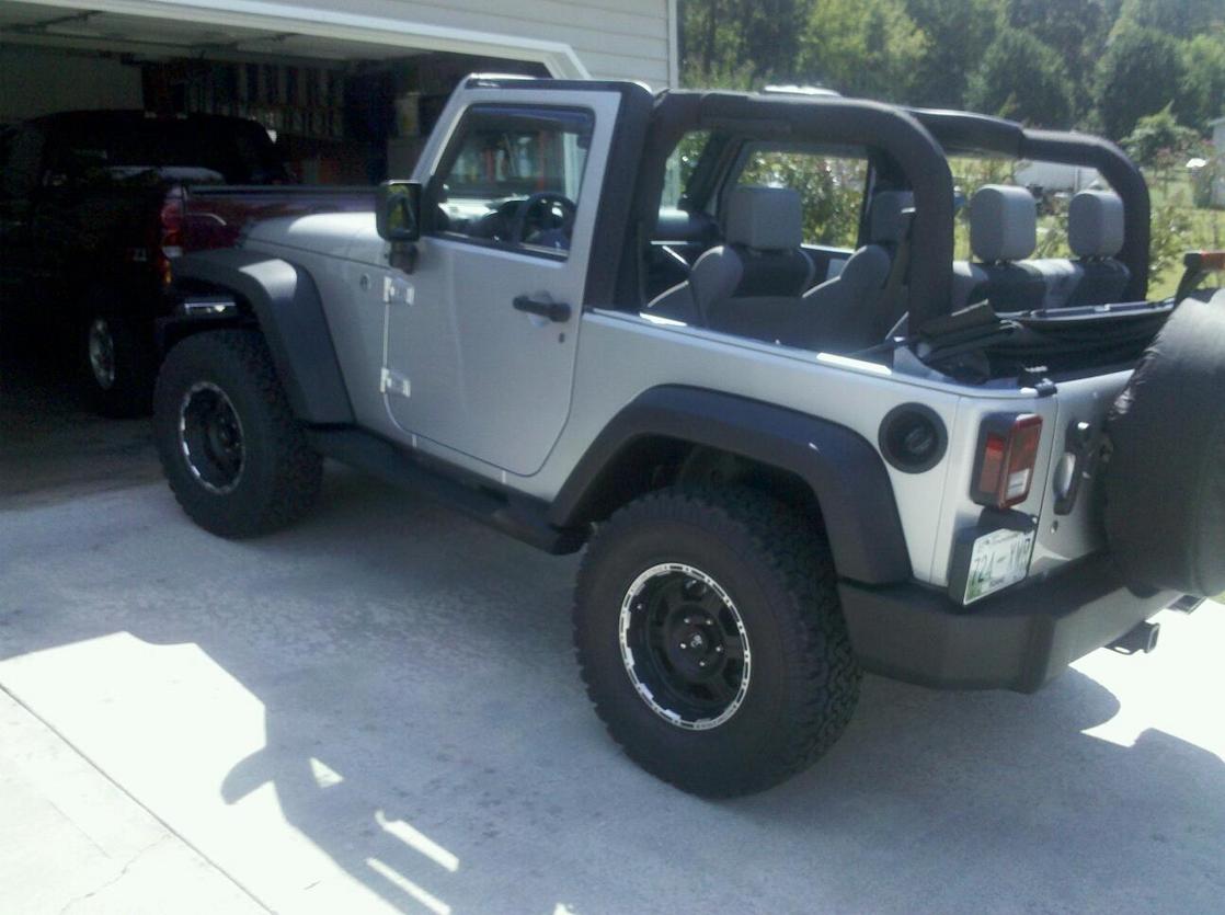

Here is mine with 1.75" Daystar Spacers and 285s. No DS issues but a few ESP problems...

Originally Posted by afdude87
Tf leveling kit. Perfect. Works great and I'd do it again, but 37s are already on the shopping list...
Are those 33x12.5?
