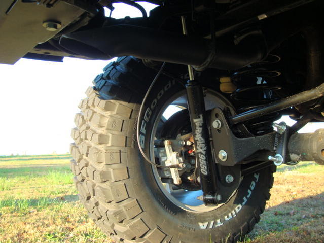

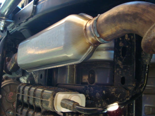

The muffler is a Hushpower 2.
ID:	19183   Click image for larger version

YTEE:
That looks exactly like the way I am trying to go with mine. If you had it to do all over again, would you?
What is the total length of the muffler? It almost looks like you have more room between the evap canister and the Hush muffler than I have with no muffler, in that spot. Is your evap in the stock location? I really don't want to have to move it.
I don't mean to high jack this thread, but I have to ask Ytee a question. Why do you have your rear TB located on the middle hole of your relo bracket versus the top hole? I ask because if I'm not mistaken you are suppose to use the top hole for the 4" lift

Originally Posted by McJeep
YTEE:
EUGENE:
I would much rather have a bolt on kit like the Gibson, but there is not a single kit in my price range. It seems that companies are way to proud of their pipes, I am having a hard time with intakes and exhausts being 4-5 times the price of thier indivual components. I guess I am just living at the shallow end of the pool.
The hp-2 is 18" long. Yes I would do it again.
