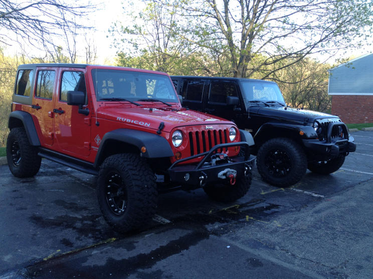

I completely agree with ^ORW on the TF 2.5" BB over the Mopar 2" kit. My brother paid $2500 for the 2" Mopar kit installed compared to my $300 for the TF 2.5" BB and my Jeep is taller than his! Yes he has Fox shocks and some more gadgets but its not worth it for only 2". It even ended up sagging after installing his bumpers and we needed to put 1" pucks on top of the coils to clear his 33's. IMO 2.5" is perfect for 33's, if you're going 35" tires then you should look at a 3/3.5" lift kit. My brother regrets his at least...
Mine is the black Jeep his is the red Jeep, both have 33" tires:

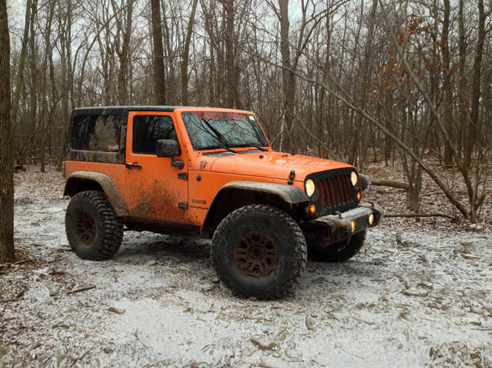

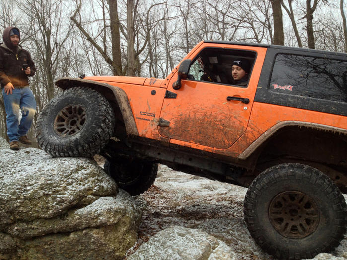

Love my teraflex 2.5" bb and 35" km2s. I'd recommend cutting fenders with either one. For $300 you can't beat it
