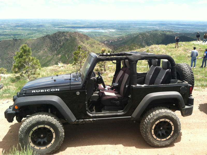

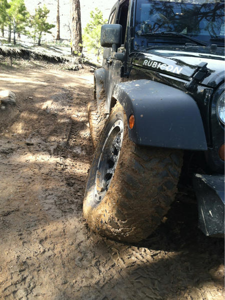

Originally Posted by Cormizer
Did you see what your height was after you put your ome in ?
No I didn't measure but here.
<img src="https://www.jk-forum.com/forums/attachment.php?attachmentid=481020"/>
<img src="https://www.jk-forum.com/forums/attachment.php?attachmentid=481021"/>
<img src="https://www.jk-forum.com/forums/attachment.php?attachmentid=481022"/>
Looks amazing thanks its funny I have 285/70/17 on right now so that's the perfect height thank you again now to look into some rear driveshafts just in case
