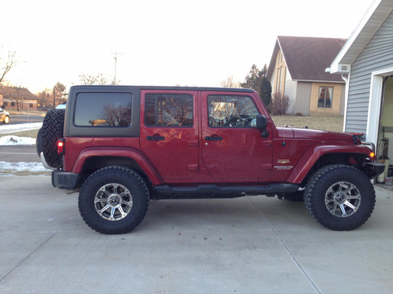

If you're planning on keeping the jeep and your installing the lift yourself go 2.5 budget boost or 2.5 coil. They will never know the difference.that way if you do plan on keeping you can always disconnect later on and or get a driveshaft.
Pic of a perfect example of my neighbors 2012 Sahara and 2.5 with 1.25 BL and 35's
