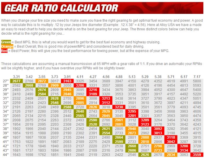

This might help. Gear Ratio and Tire Size Calculator - 4x4 and Jeep Ring & Pinion

That table is for a 1:1 transmission ratio.
The numbers do not apply to the 4th gear in a 07-11 automatic, 6th gear in any manual JK, or 5th gear in a '12+ automatic.
There are tables in the FAQ sticky at the top of the Modified Tech section that have actual rpm levels by transmission type.
You're not serious are you? The chart still gives a baseline of the changes in rpms for given gear ratios. The 5spd auto and 6sp manual and about identical at .83/.84 final drive ratios respectively. I didn't think simple math caculation explanations were necessary.
Most people don't read the details that those numbers are 1:1, and few know the final gear ratios for their transmissions.
Sadly, many can't do simple math either. They fear extraordinarily rpms or think their top speed will be limited with lower gears.
That is why these were created:
