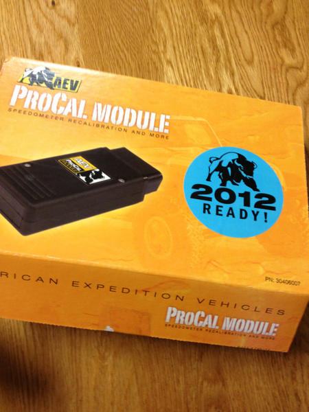

Yes but thanks for trying to help!

It lets me do the runtime changes. I just tested the high idle and it works fine.

Hmmm... I'd check with who you got it from. It won't work correctly if he didn't use it to reset his jeep to factory default. That's what releases the vin so it can be used on another.

I'm the seller and we've been PMing all day. I followed AEVs instructions to the letter to reset my rig and got the expected three beeps when it was complete. Even verified that the speedo was no longer calibrated.
I've offered jrmcgill to either return it to me for a refund or to go through the unlock again based on what he determines after talking to AEV tomorrow.
But someone help me understand why some functions would program on his rig if the procal was still locked to mine? Shouldn't it have given an error right away and for every setting?

I even did the ecu reset that aev recommends in their forum as a last resort to reset all codes. Still getting the error code

I think you're right man - sounds to me like it was a "bad reset". Not sure why they even include the ability to reset and unlock the module when the mods on AEVs forum openly state that even when a reset is performed correctly, it may not always actually unlock the module.

So for those patiently awaiting the outcome, lol, here u go. Spoke with AEV tech dept today and the guy was more than helpful. Told him exactly what the procal was doing and he said they see it all the time. It's why AEV highly recommends not buying a used procal. He said even with a correct reset sometimes the procal is junk afterwards. What happens is as soon as the procal recognizes a new vin after the first programmed function it locks up and will not do anything. So that answered all my questions as to what the problem was. He also said there is no fix whatsoever besides a new procal. Which I cannot comment on whether I am receiving one in the mail for the old one or not. But for those who have had this problem and for those that will be searching the forums concerning this problem I hope I helped you!
