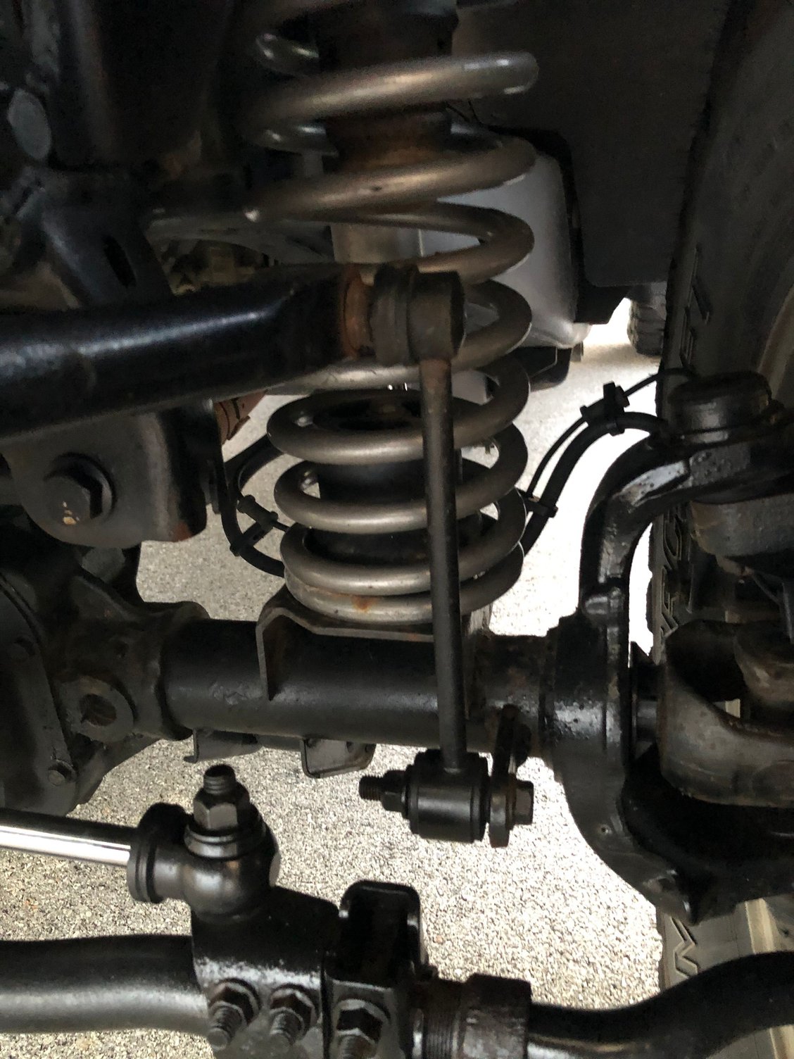

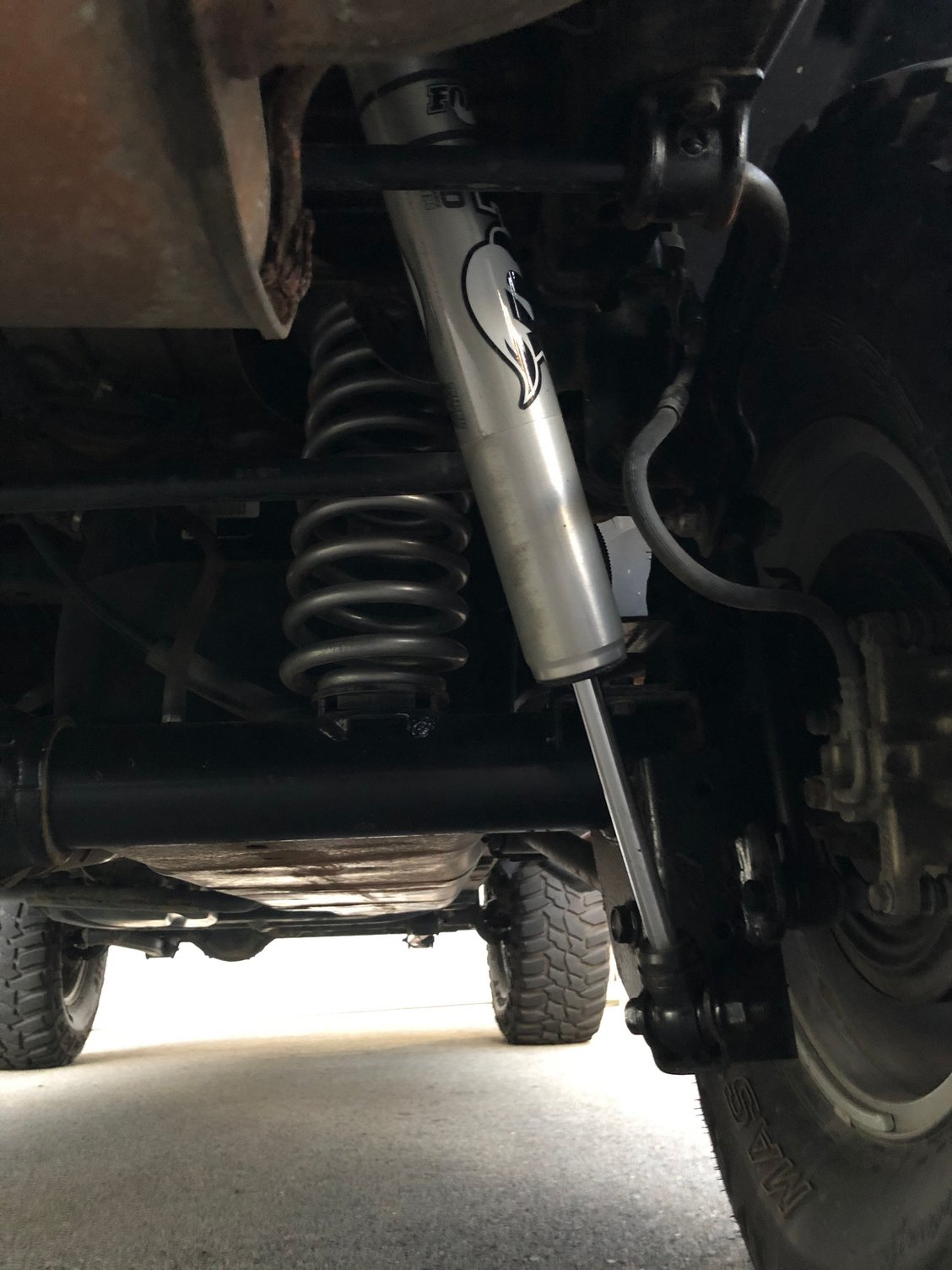

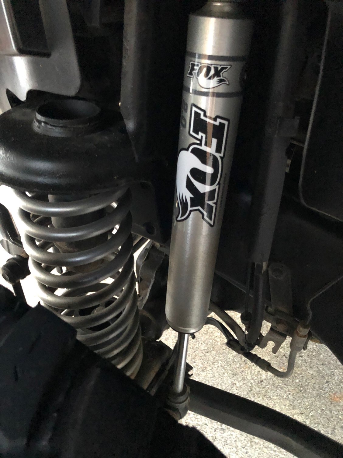

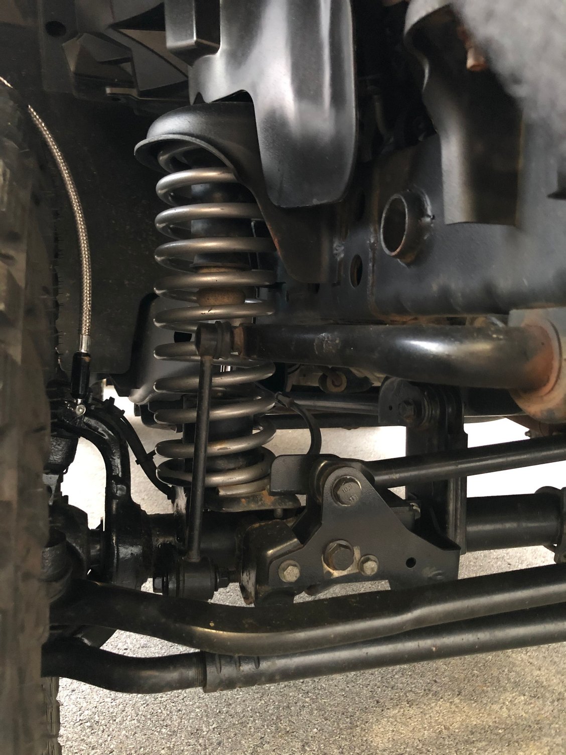

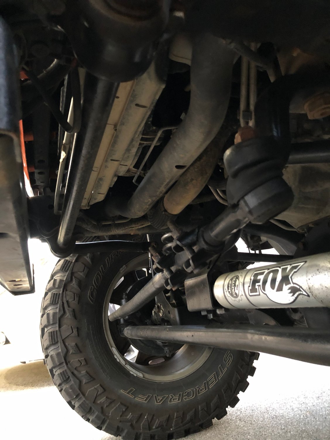

Take some pictures. Both ends of the front arms, steering components, any brackets on both trackbars, etc. Maybe we can help you figure out which lift you have and which components are/are not installed.
Here is some pics for you. I guess it is what you are needing. Some of the front and rear suspension.
