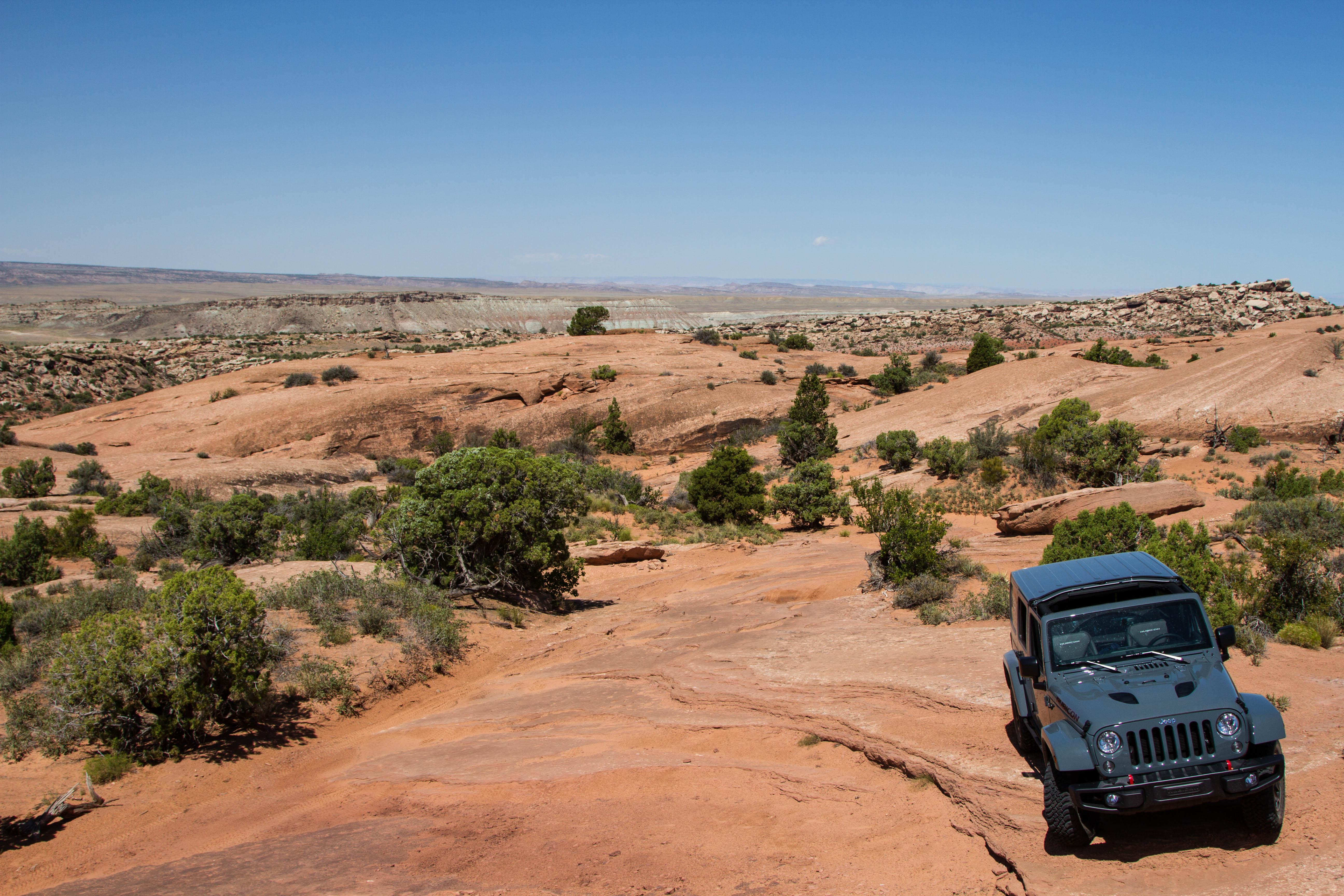

I've been lurking on here for a long time and finally decided to Join now that I've bought my 2nd Jeep and in a position to actually modify it. Hooray for a steady job and understanding wife! I've found a couple of older threads that answer some of my questions but not all.
I have a 2015 Rubicon Hard Rock and I plan on buying Gobi (stealth), RTT, and adding a winch. I don't do a lot of crawling, mostly logging roads, forest service roads, or double tracks out to my favorite runs on the Olympic Peninsula, think more overland or expedition style. I really like the ride height on the stock rubi, so i'm not looking to gain altitude, but what I am concerned about is weight. With the extra weight of the rack, tent, winch and gear, what do you guys/gals think my best option is for keeping my stock height/travel. I'm driving myself crazy trying to figure this out. I've researched full blown lifts, HD coils, even airbags. This jeep isn't a daily driver per SE, but I drive it 3 or 4 times a week.
Any/all opinions are welcomed, even the off color rude remarks are fine too, they make me laugh. Thanks in advance!!!
-Tony
