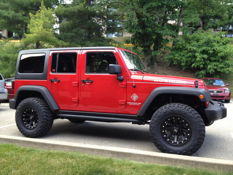

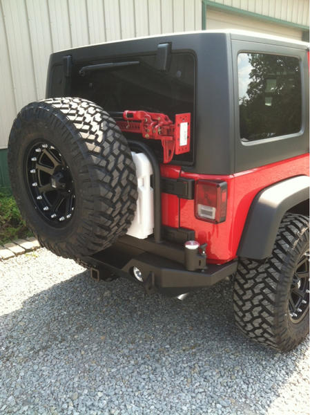

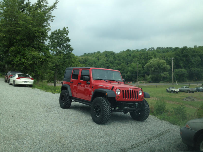

With a -12 back spacing my tires stick out past the fenders a good 2 inches. Tread sticks out 1/2", technically illegal in PA.

Forgot to add these tires are heavy duty and have a lot of weight... 3.21's and I wouldn't go any bigger until a regear to lower the stress on your Jeeps components

Tripp, this is the same combo I am about to put on my red rubicon. How much lift do you have?

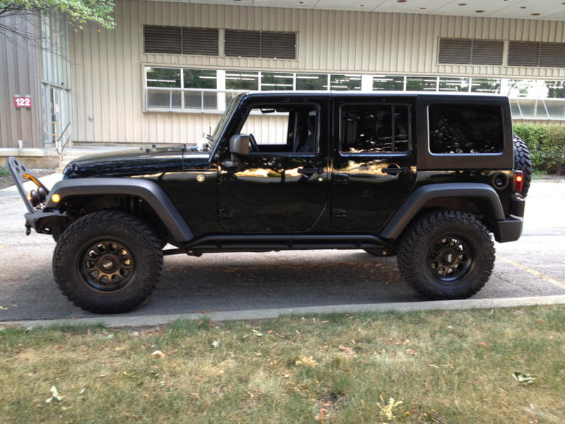

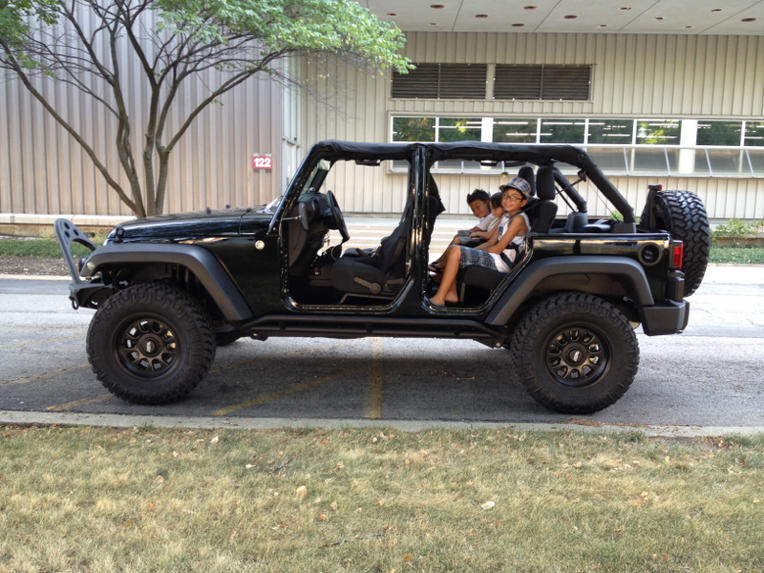

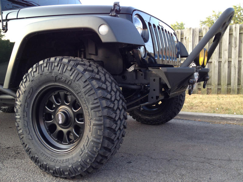

Hi got the 295 ntg
