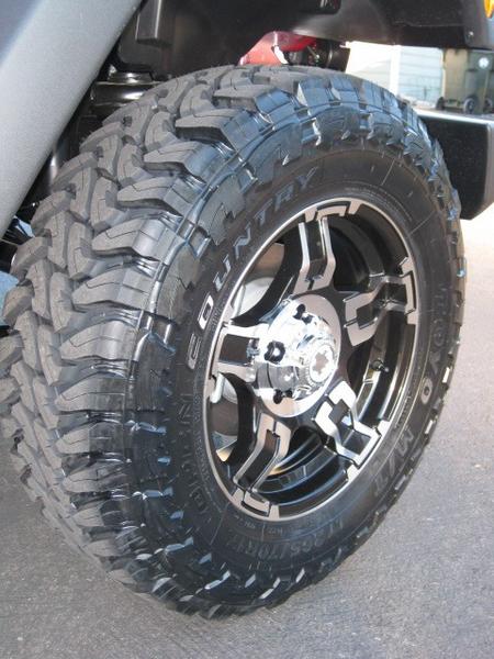

the Toyo's are a much stronger tire. It comes with a price... It weighs about 12# more per tire than the same sized KM2
Look at the the load rating on them. Plus the sidewalls are much stronger on the Toyo's. Translation is they are more durable when aired down and for rock crawling

That side wall is thicker, but its also a harder compound. They wont conform to the rocks as well as the MTR's when aired down

I have had both the Toyos and KM2's, I prefer the KM2's and they will go on my new Jeep. The Toyos are good tires but like was stated above they don't conform to the rocks very well. I would air them down to 9lbs and barely have a sidewall bulge.. (38's)..
