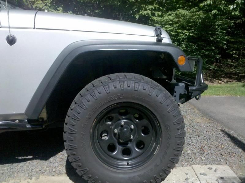

I found this picture online and like this trim job. This is about as much as I'd be willing to trim.
If I end up going to flatties, I'll probably end up selling front and rear bumpers and go with something that will look better. That's something I want to avoid though.

Originally Posted by MOPWR2U
2.5" lift, 37s, and wheels with 4.5" backspacing.
I've seen this before, and LOVE the look!! Do you take it off-road, and what's been your experience.

Old Oct 6, 2014 | 08:22 AM
MOPWR2U's Avatar
Posts: 661
From: -
I took that Jeep off road all the time, but not with the stock flares on it. The tires rubbed pretty bad, even on the street, with stock flares. I've done the low COG approach, as you can see in the picture, and I've done a more conventional lift. The low COG approach looks good, but it doesn't work very good. Up travel is very limited, and off road ride quality suffers because of that. You have to go a lot slower, and still spend a lot of time on the bump stops. That Jeep had a 2 1/2" lift and 37s; my current Jeep has a 3" lift and 35s, and it works a whole lot better. You really need that little bit of extra up travel.
Yeah that makes sense. So, I'm wondering if the extra .75" lift and maybe the 1" I take off the flares will work. My wheels would be .25" pulled in more than yours, but who knows if that will make a difference. How wide were your tires? 12.50 or 13.50?
Old Oct 6, 2014 | 10:26 AM
MOPWR2U's Avatar
Posts: 661
From: -
My tires were 12.50s. For 37s and stock flares I wouldn't do less than 4" lift. But if you're trimming the fenders like in that picture, 3.25" of lift is probably going to be fine, and allow you to run a little shorter bumpstop. Those trimmed fenders look nice by the way; thats the best trimming job I've seen on stock fenders. They usually look like something farm built.
