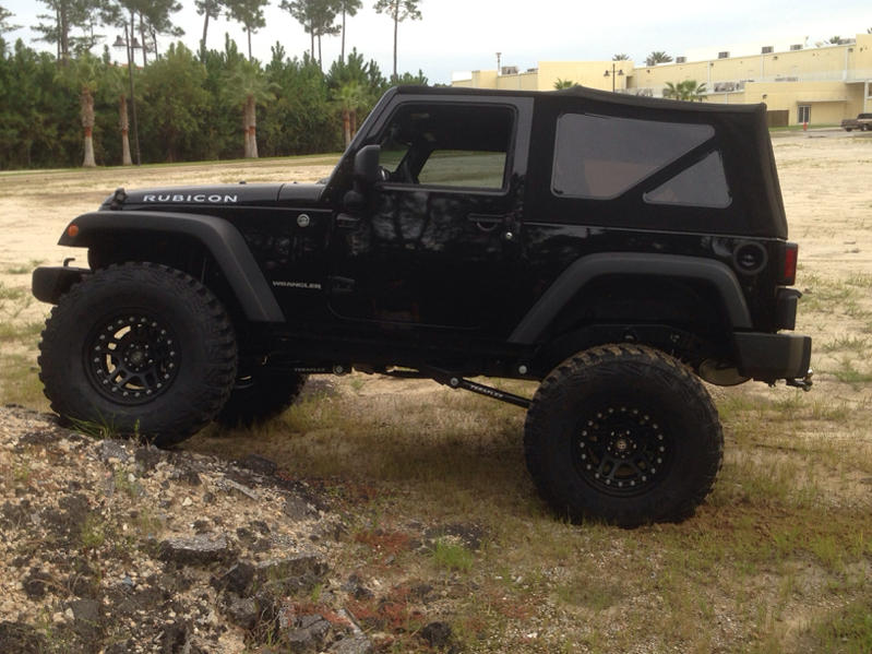

37s MTRs and 4" teraflex LCG long arm kit
What part is LCG? I mean, 4" is 4". With the bump stop you must be running, that's a higher center of gravity than what most JKs are running.

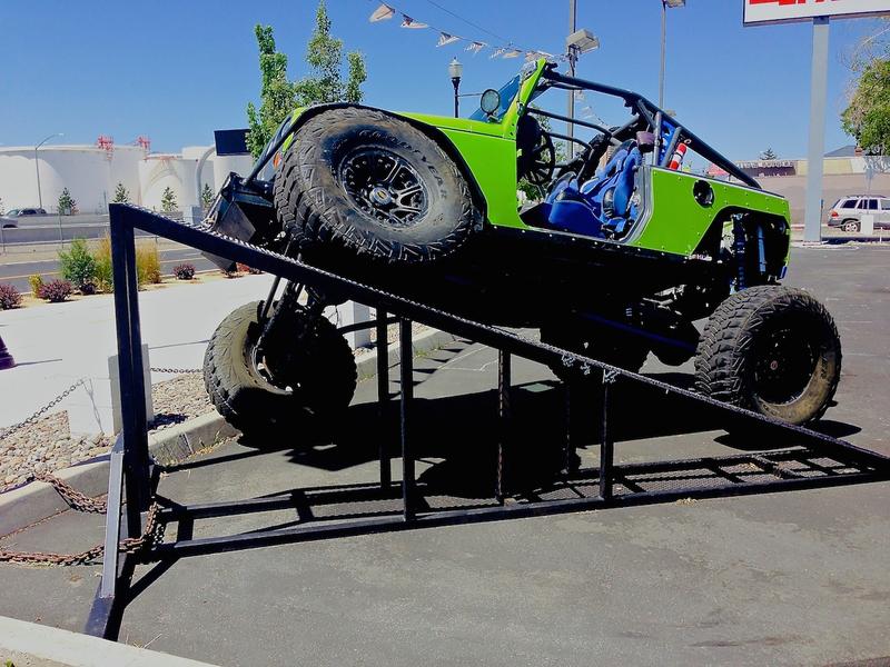

This is what a 4" long arm kit should look like in terms of articulation.
not to beat up on you here but is that thing at full bump in the picture?

chasttd's Avatar
Joined: Sep 2014
Posts: 14
From: Orange Beach, AL
Yea. Gunna need to figure out fenders.

JE8154's Avatar
Posts: 2,256
From: Madison, New Jersey
Is that a yes it's at full bump?

Originally Posted by TheDirtman
This is what a 4" long arm kit should look like in terms of articulation. <img src="https://www.jk-forum.com/forums/attachment.php?attachmentid=578826"/>
That's a nice looking Jeep and Jeep articulation shot
I've been thinking a bit about a 4" long arm, how do you like it and whose lift kit did you go with?

Originally Posted by Matthewd5
That's a nice looking Jeep and Jeep articulation shot I've been thinking a bit about a 4" long arm, how do you like it and whose lift kit did you go with?
that's a good way to insult him
