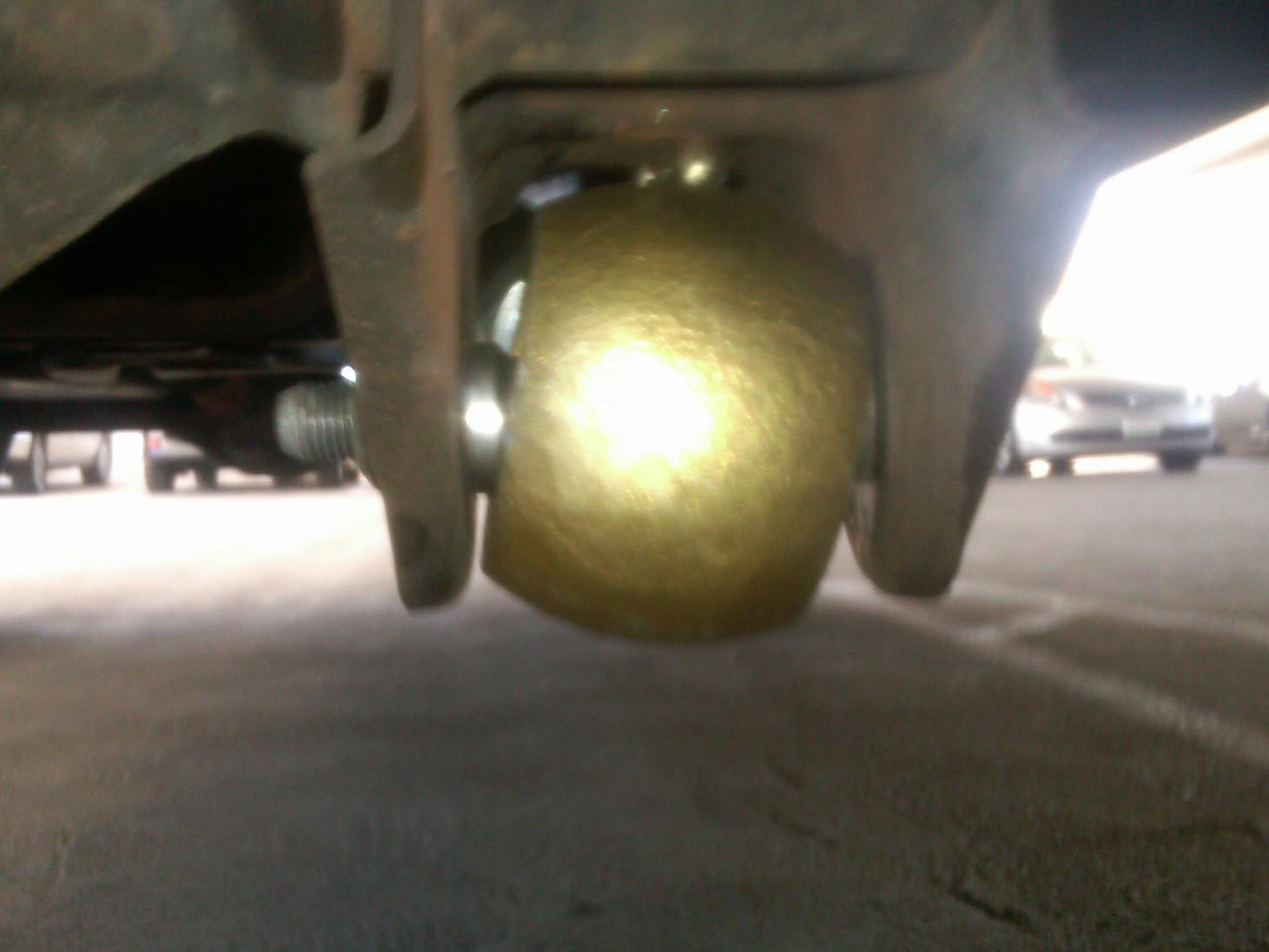

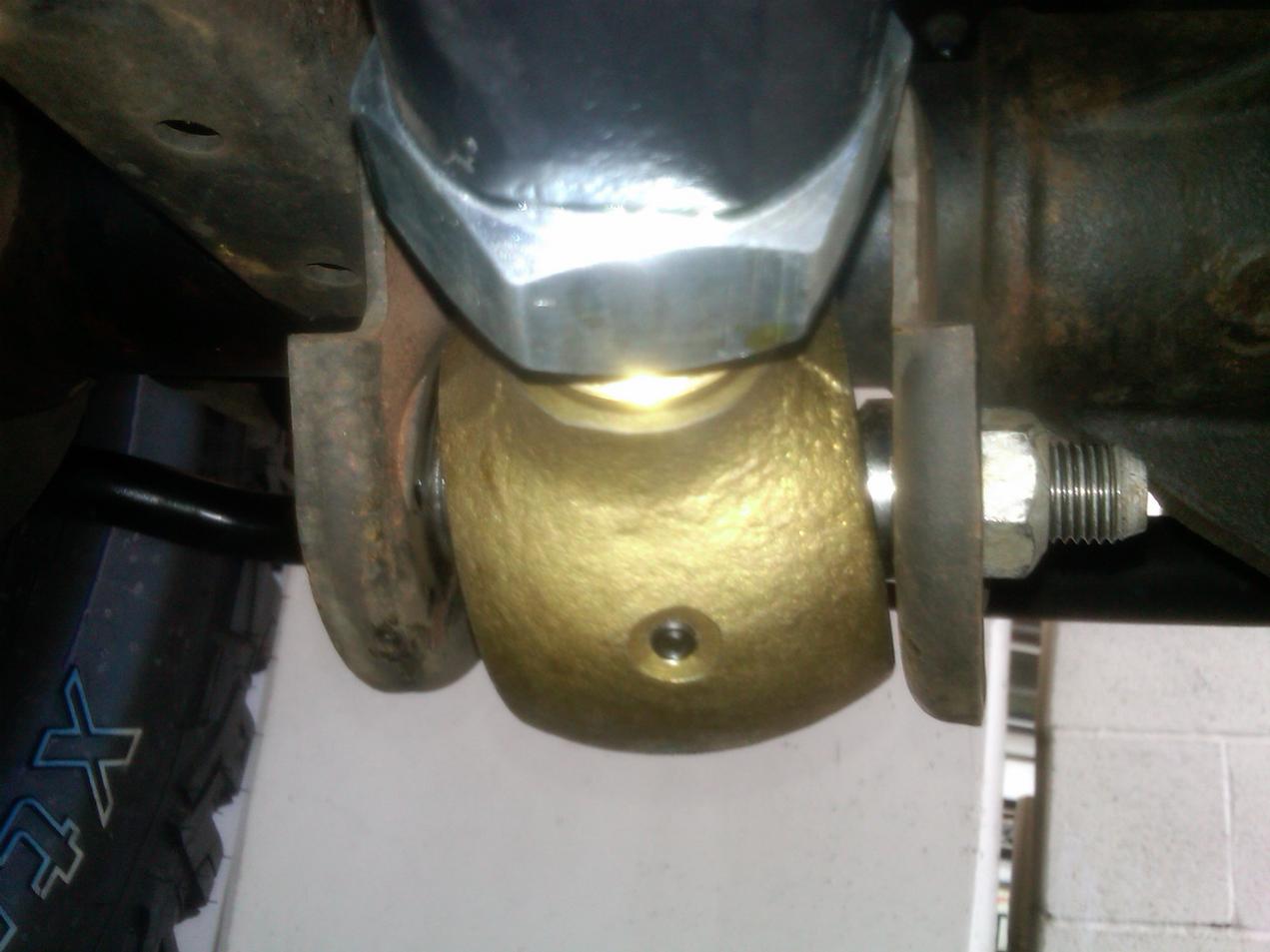

Lower Control Arm Balls are Crooked
Thanks Guys for your input! Got it in. Next question, the ball on the lower control arms seems crooked. I called tech service but I didn't get a sufficient answer so I turn to the forum. Attached you will find the pictures.
I followed the instructions which stated the zerk should be up, but it seems weird for that to be the case given the low clearance in the axle mount (looks like the zerk is touching the axle mount) and the difficulty servicing it.
Any help would be appreciated! Thanks in advance.
