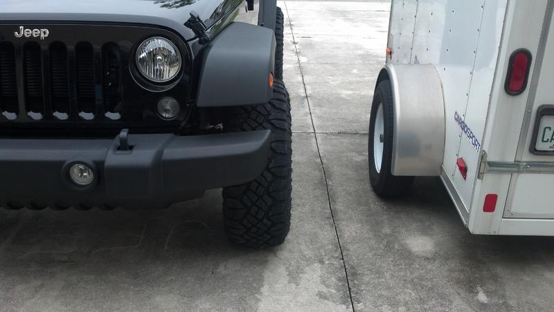

I've got the 15" Trackers on mine with the -19mm offset, and I can tell you with 12.50" Duratracs, the stance is plenty wide. The tires extend past my stock fenders by probably 1.5-2" on either side. I really like the look (this is before the 2" lift in the front):

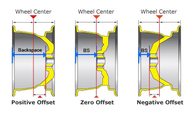

An offset of -32 mm equals a backspace of 3.5" to 3.75" depending on the width of the wheel (8.5" to 9").
If a backspace of 3.5" to 3.75" is what the majority of JK owners are running then I shall stand corrected.
