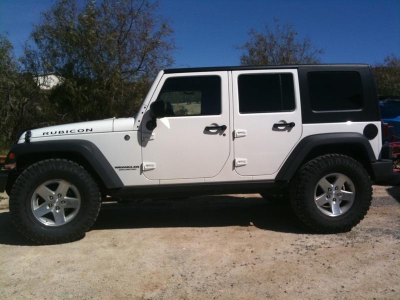

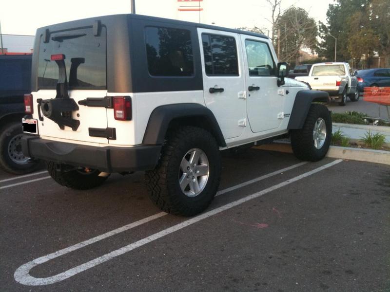

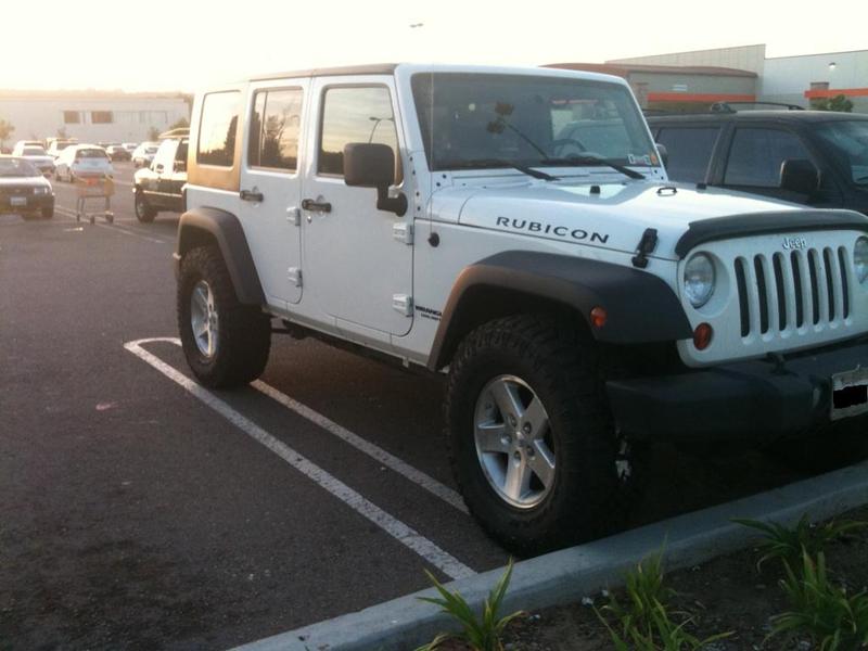

You can run 315/70-17 Duratracs with no lift. We have 1.5" spacers on the stock wheels, would think 17x9s with 4.7" backspacing would be similar.
That looks like it has a small lift in the picture? You are 100% on stock suspension? Just wheels spacers? If it works for you why is everyone saying it won’t work for street use?

100% stock suspension. Have the lift sitting in the garage waiting on me. I did trim the plastic airdam in front, and cut the sliders/pinch seam. Only had 1/2 inch clearance there.

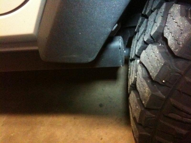

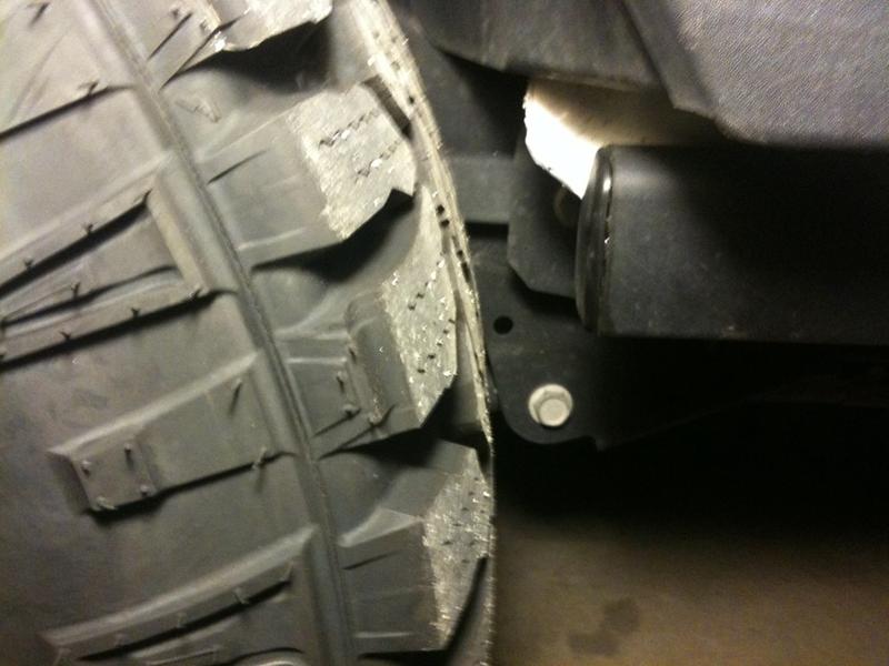

Front and rear? Can you post a pic of how much you cut? Dos cutting the pinch weaken the structural soundness of the Jeep? Why do they make it sticking out like that?

Before and after cutting rock rails.
