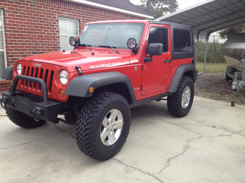

No shame in 34's. great compromise size.
