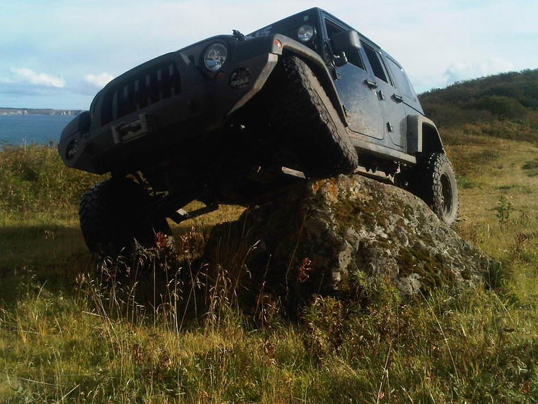

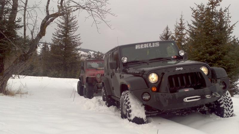

Speaking of drawbacks expect the jeep to lose a significant chunk out of the MPG, and the already sluggish Jeep will be worse. I can still do eighty down the freeway, however, i just dont have much of a passing gear.
With the Rubicon we get the 4.10s and 4:1 low range with lockers, so the only drawbacks off-road (with the 35s) are the added strain on steering components, balljoints, axle tubes, etc.
For 35s i'd reccomend the four inch lift as well. I run Rancho, and will never run anything else. This will give you ample clearance for the 35 inchers. As far as offset goes, the best way to check if a tire will rub is to test fit the wheel/tire combo.
Pics attatched
All in all if you are indecisive jump on the 35s. You will wish you did eventually.
