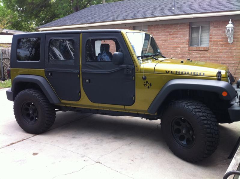

Here's my 3" BDS lift with 17" addicts and 33" Nitto Trail Grapplers

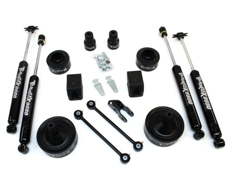

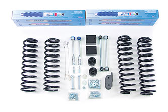

Keep in mind I have the upgraded shocks which are Brushed Aluminum instead of white. Anyway, a lot of people will tell you that the Terra Flex 2.5" budget boost is the best. and it is very good. But the difference is that the Terra Flex has spacers for the factory coils and shocks. The BDS has shocks and lift coils. the price difference is a couple hundred bucks. Plus the BDS comes with Quick Disconnects for more Flex on the trails. I also use my rig as a Daily Driver and it drives better than stock because of the better coils and shocks.

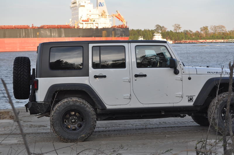

This is my rig with a 3" lift and 33s
Not the best shot but the only one of I have with a side view at the moment.
Steering stabilizers might be upgraded if you went to a bigger wheel like a 37. If your suspension and steering is setup right you can run without it.
I am particular about how my rig handles, so I added front adjustable LCAs, an adjustable front track bar, and a rear track bar bracket. I did add extended brakelines in front, my SS is stock.
Probably more than I needed to do but it does ride nice. I am upgrading the SS to a TF 9550 SS but that is because our buddy over at Northridge has a package with a JKS SS relo bracket and an SS that is just a good deal.

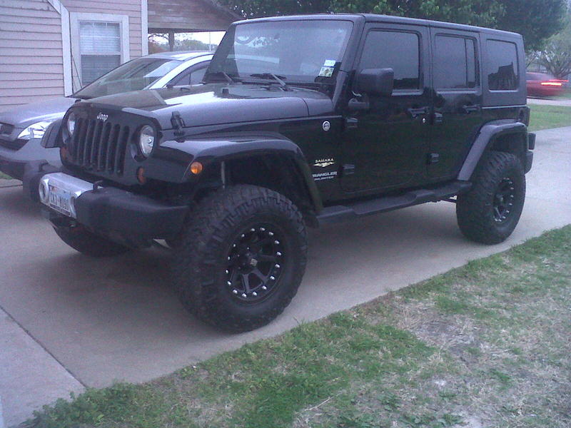

im the same as matador, 3.5 lift with 33's i like the mpg and the way it performs on trails. I have no complaints

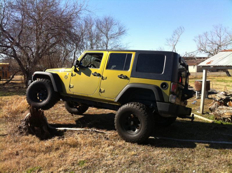

This mine with teraflex 2.5 and 35s bfg km2.
