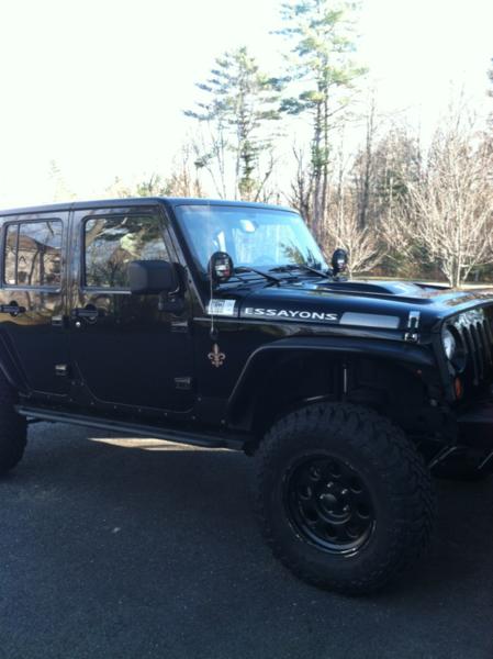

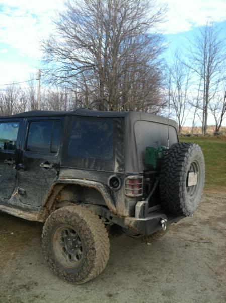

I have 285/75/17 Toyo MTs. Was told that they measure out to about 33.8" which is essentially a 34".
ID:	245911Click image for larger version
