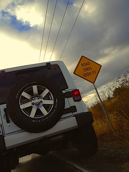

Nothing wrong with 34's. It was the first set of tires I upgraded to before going to 35's then 37's. I sold them and the wheels though after getting the lift.
34's on 18's on stock carrier...
