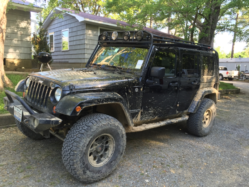

I am happy with my 35's but I wasn't ever considering a 37. If your split between the two, go big. Here's mine with 2.5 inch Rock Krawler and 315/75/16's.
