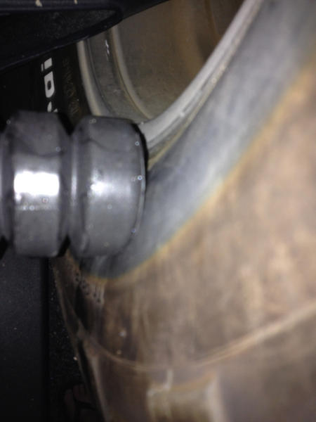

Well I ended up with the TF relocation bracket. Once I mounted my 35x12.50R17 BFG on stock Moab rim, I realized I would definitely need longer bump stops. I got the Daystars in this week and mounted them today. They barely make contact with the tire. What's next? I've considered carrying my spare on my Congo Cage but I think my five tire rotation would become a pain in the but. I have looked at the new TeraFlex carrier and others but they seem expensive for what they are. I've also considered changing the rear bumper to something like the Poison Spyder Brawler, as it accommodates a 35" tire on the stock carrier but I wonder if my Congo Cage would look weird where the rear bracket meets the frame. I'm about to go crazy. Can anyone point me in the right direction?
Old Jul 15, 2012 | 04:54 PM
  #48
SBEII's Avatar
Posts: 1,975
From: Myrtle Beach, SC
Pics of the Daystar bump stops. I can spin them with my hand.

I'm running stock Moab wheels. Be very careful with the bump stops. The tit that goes in the door is very fragile.
