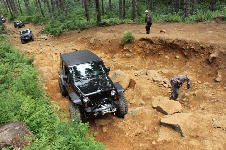

Running 37's on a stock D30 with no reinforcements.
ID:	216772   Click image for larger version

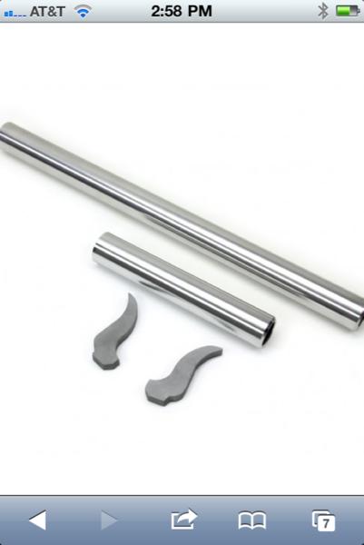

Would this TeraFlex Front HD Knuckle Gusset & Tube Sleeve Kit be a recommended setup? If so, $120 + installation is pretty cheap insurance.
I ran and wheeled 35" Toyos for over a year and 37's for a few months without any reinforcements but knew it was a matter of time. So it's still a good idea for a minimal investment.
Those are nice, but have you seen the Evo setup? I like that it covers the C at the top and bottom.
http://www.northridge4x4.com/proddet...od=EVO-C2-PACK
