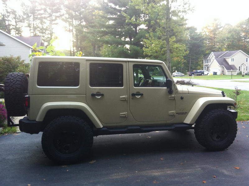

On monday I put 35's on my 2011 jku sahara mounted on AEV wheels and did a 2 inch lift. I have 3:73 gears and an Auto. I used a pro cal to change the
shift points and it seems to be pretty good. Eventually I'll re gear.Click image for larger version

I would definitely gusset the front (d-30) axle. And at some point think about a re-gear. Good to go

...except the OP has a Rubi - with a D44 front axle. I'd say throw some C gussets and a Flashpaq at it, and you're good to go as-is.

Looks sweet
OP...with your Rubi's D44's, I wouldn't hesitate to go 35's. Now as far as that money pit situation is concerned, the additional reinforcement is cheap insurance as you mentioned, I'm also a big fan of the Superchips, and it's never too early to look into a rear bumper and tire carrier to support the additional weight of your heavier spare
