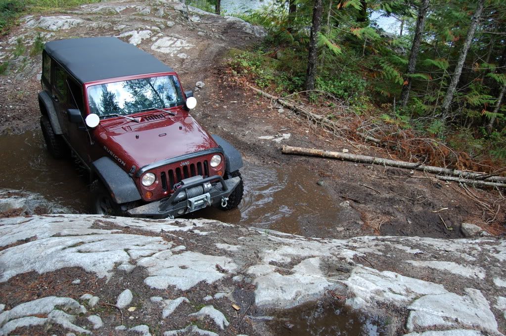

For me, when I ran the TF2.5 BB, 35 inch Procomp Mud Extremes, 99% of the time I didn't rub at all.....But there will be the odd time when you can still rub the rock rail, more specifcally when in a serious off camber flex when there is allot of force on the rear axle......but for the most part, I wouldn't worry about it.... easy enough mod to do whenever you want.....
here's a pic when I rubbed the rock rail, but only because most of the weight of the Jk was on front passenger tire and the rear drivers tire.....the drivers rear rubbed, but no damage
