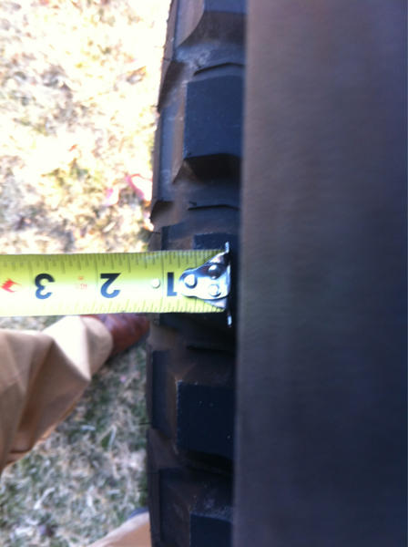

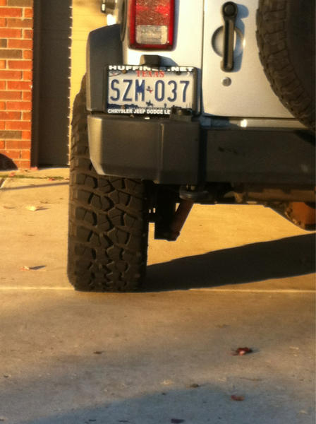

305 width on a 17x9 with ~4.5" backspacing:
Attachment 483634
Attachment 483636
I think it will be too close to even tell.ine measure a full 12" wide. 1" wider tire means it only sticks out 1/2" more. With your wider flares you should be a-ok.

Attachment 483634
Attachment 483636
Sent from some string and a few tin cans.
I'm not sure if this is true or not but is it possible, just like wheel diameters, there is a difference between listed width and actual width? That would explain why some say it will work while others on the forum say no? Just a thought.

If you've got 15 minutes to spare, read through this post... https://www.jk-forum.com/forums/modi...verage-277876/
Great find on the link above! My measurement in my photo validates the thread you found. My rims, while often called 4.5" backspacing for ease, are actually 4.6". Combine this difference with about 1/16" where the tip of the tape isn't perfectly flush and you're good.
