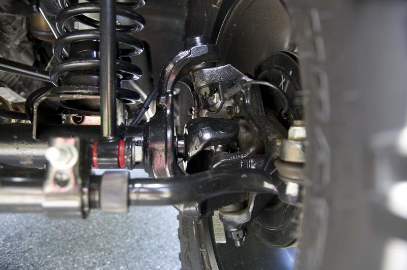

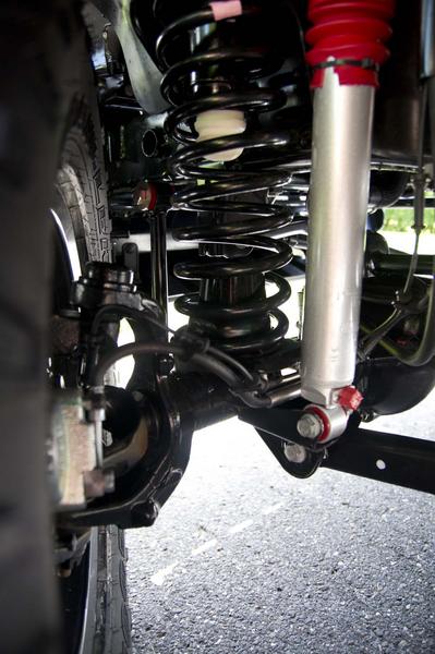

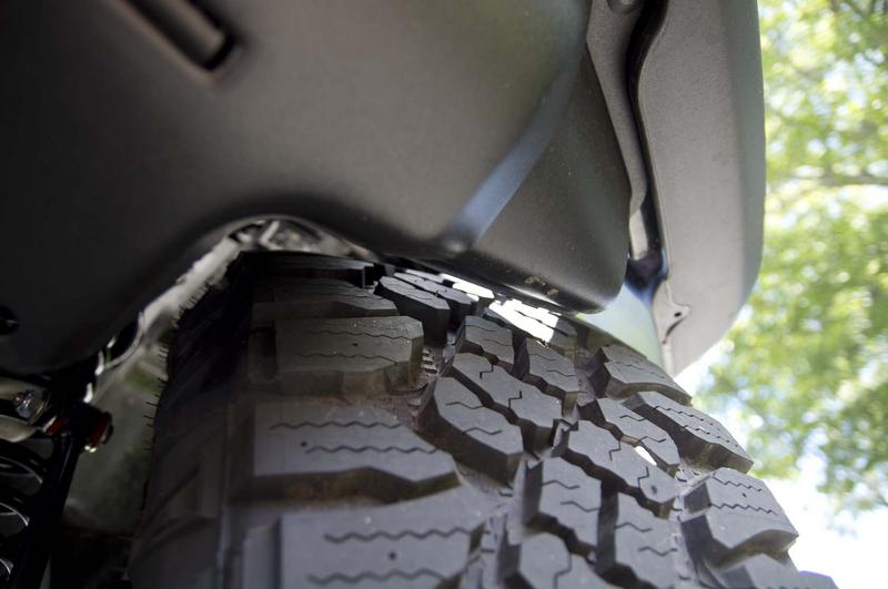

HEre are some pics to back up the fact that an 18x9 wheel with a 5in Backspace will work.
LEft Wheel turned right picture taken from the back.
Name:	LW Turned Right  from Back.jpg
Left Wheel turned right picture taken from the front.
Name:	LW Turned Right from Front.jpg
Left Wheel turned Left picture taken from the front.
Name:	LW Turned Left from Front.jpg
Even with a 4 inch lift, I cant beleive how close the tire is to rubbing the stock bumper.
Name:	Close to Fender.jpg
*****Disclaimer*****
While you can use 18x9 wheels with a 5in Backspace, more than likely, the wheel will not allow you to use the stock tire carrier. Mine hits the top of the back bumper. THis is why using a 4.5 - 4.75 backspace is probably good advice to follow. a quarter of an in less in BS and I probably would have been able to mount the wheel on the tire carrier.

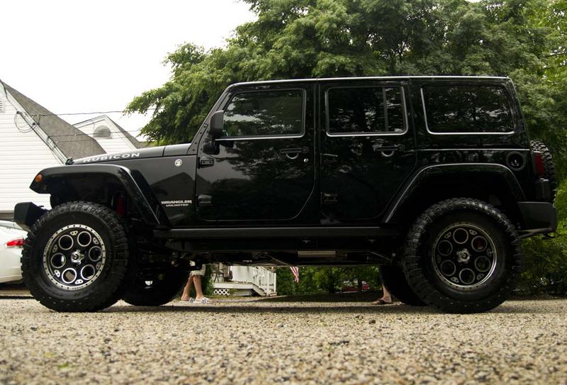

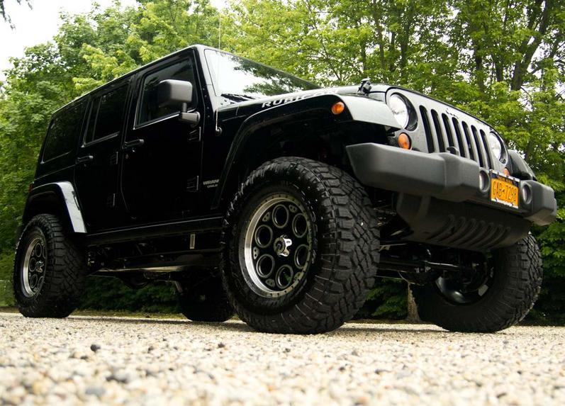

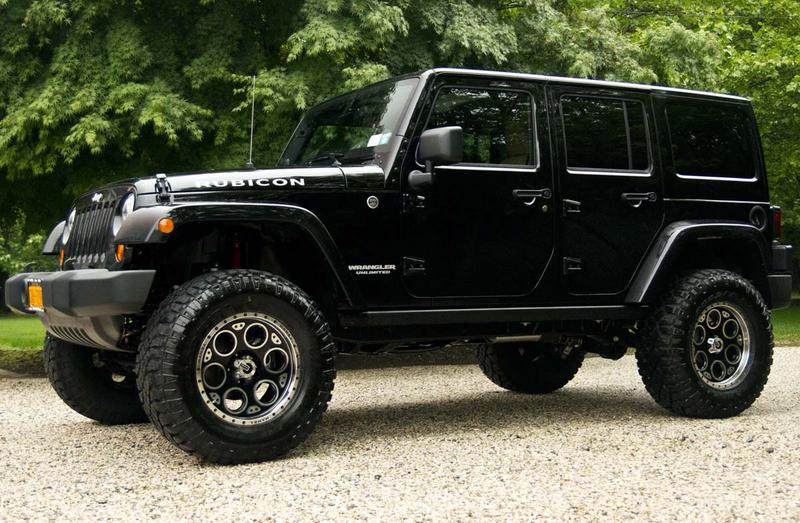

Your wish is my command. Here she is.

Your rig looks great!
Old Jun 18, 2012 | 11:46 AM
powrsurg's Avatar
Posts: 988
From: Middle Island, NY
Thank You. All that has been done to it is wheels, tires, and lift.
