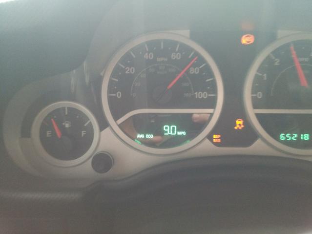

I have a 2010 I need to regear ASAP.
3.8, manual, 3.73 gears, 35" Mud Grapplers, 2 door. I live in SE Michigan and it's generally flat.
Hauling ass home from wheeling trip in Manistee National Park this morning to work I was driving into a strong headwind, and 6th was useless. Even on the flat stuff going 75 it was quickly slowing me down, even at about 2400rpm. Had to stay in 5th (admittedly driving faster than I normally would on expressway -due to gearing and mileage I stick to 65ish, just enough revs to keep moving on the flats) and hit a new low for mileage.
I guess what I'm trying to say is that even if 3.73 normally works (thank God for 4lo!) there'll be a time it doesn't. I mean, I've had issues on steeper hills before, but the wind straight up made me it's bitch,lol.
Anyway, while flatland on 3.73 is usually tolerable I can't regear fast enough now! Just thought I'd add my .02.

Edit: also meant to add that having a manual makes it easier to coax power out of crappy gearing, cos I thought I saw someone mention it backwards earlier. Pardon me if I'm mistaken or it's already been corrected! 😊
