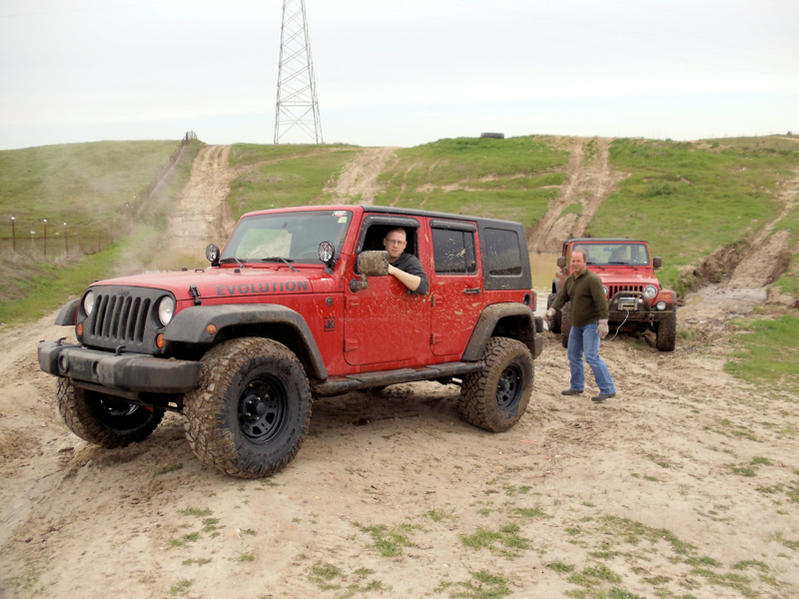

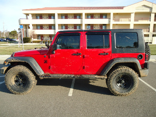

I have a 2010 JKU auto on 35's and I haven't regeared yet. It's not as bad as I thought it would be, but you'll definitely feel a difference in power. The only thing I've used so far is my AEV Procal to set my shift points and speedo for 35's.
ID:	315285Click image for larger version
ID:	315286Click image for larger version
Definitely worth it though. It's my DD as well.
