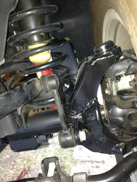

Just had mine done... doesn't seem like they're in the way.
If you have a shop doing it, might as well get CA skids too since the welder is already out.
Attachment 497120
Where did you get yours done? I too live in the South Bay.
