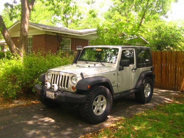

So my wheels and tires came in earlier than expected, lift will not be in till next week. Getting a little anxious and wanting to put them on now. Has anyone done this before? Will it rub, or just be patient? (no fun)
Old Oct 13, 2011 | 12:34 PM
TexasTj's Avatar
Posts: 326
From: Austin, Texas
I have and Drove my Jeep that want for three months in 2008. It only rubbed if i hit a big bump at speed over 40. I mean like Speed bumps.
