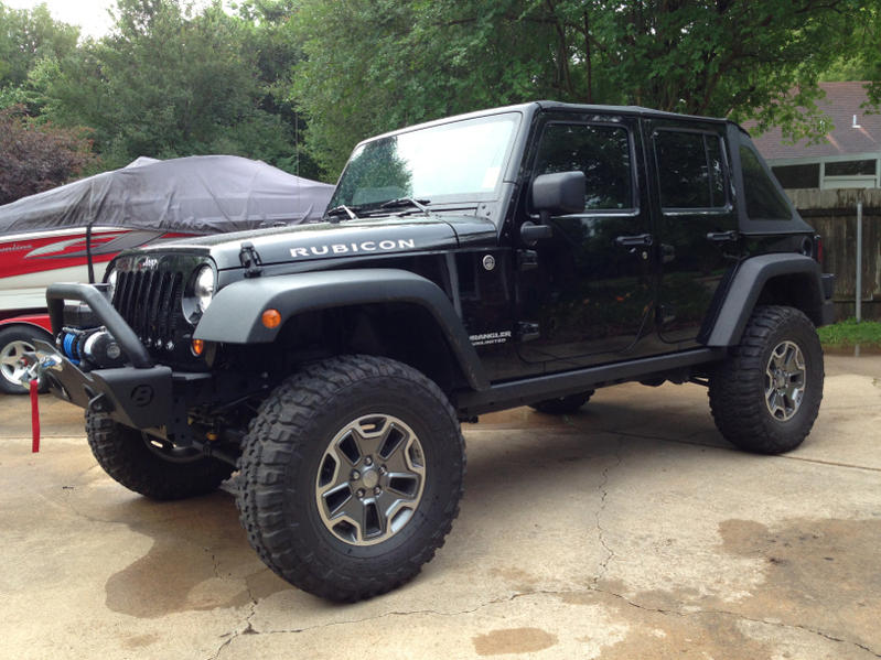

Yes, 35x12.5 will fit on the stock Rubi wheels. But, you will need 1 1/2 wheel spacers.

Yes they will fit, here is a pic if 35's on stock wheels and 1.5" spacers

Thanks so much, they look great too!
<img src="https://www.jk-forum.com/forums/attachment.php?attachmentid=468118"/>
Looks amazing!

Yes, they will be fine with 1 1/2" spacers, but don't forget to lift it...
