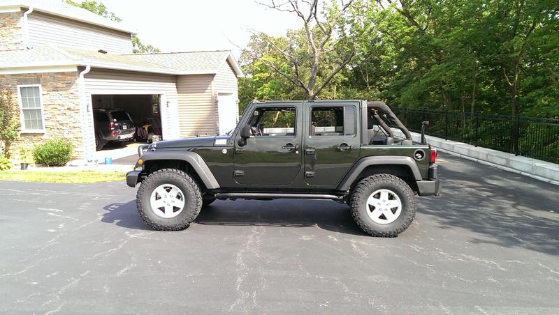

From: St. Louis
I'm running 315/70/r17's Kelly Safari TSR's (35's) with a regular Teraflex leveling kit and it works perfect. The tires measure out to exactly 33 7/8. Of course i'm using 1.5 in. spidertrax spacers because of the stock wheels backspacing.

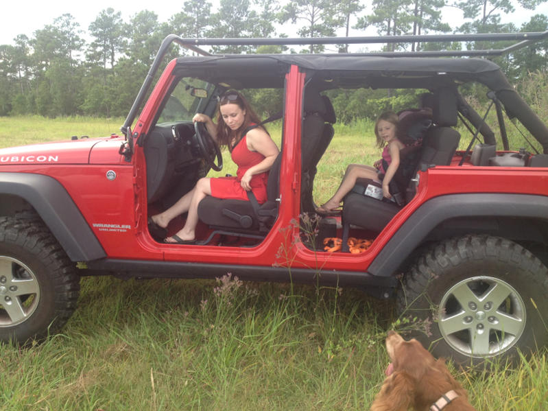

From: Myrtle Beach, SC
I ran 35x12.50 on one for almost a year. It's great on the street. You will need to trim the fenders and pinch seam if you do much off roading.
