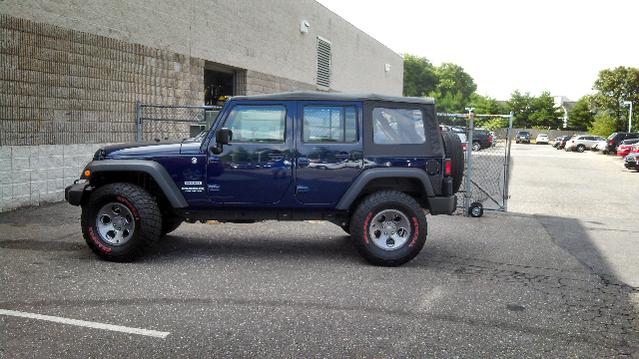

anybody running 35's on their teraflex performance leveling kits? any pics?
35' general red letters on AEV Sevegre with the Teraflex leveling kit.

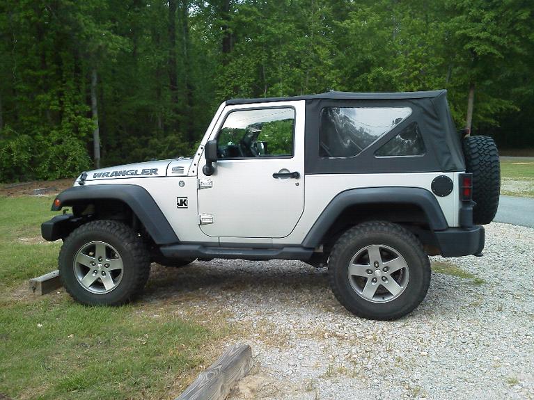

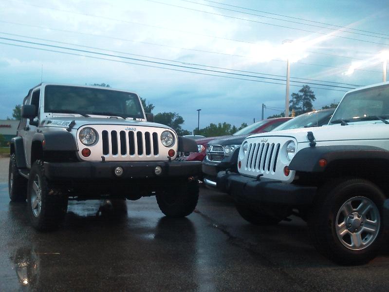

Some suspension lifts are taller than what they advertise. Example, Teraflex 2.5" boasts 3.1" of lift. Spacers are usually accurate. Due to spring rate. I added 4 dr springs 18/59 and gained around 1.5" in front and about 1" in the rear and added TF leveling kit. I will add 35's later but also in addition to extended brake lines, bumpstops, trimmed flares, pinch seam and/or whatever Planman might suggest please. I'm running 32's until they wear down. I think my ass sits a little low and hoping front bumper and winch might fix...suggestions?
Before
After

ID:	480691Click image for larger version
ID:	480692Click image for larger version

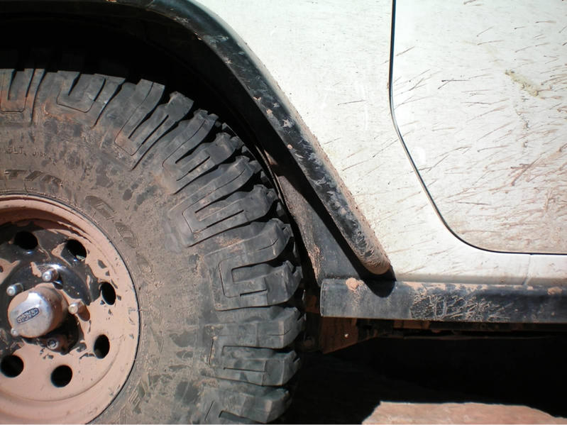

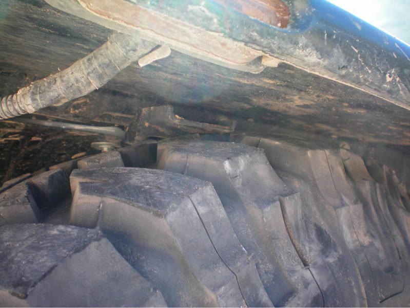

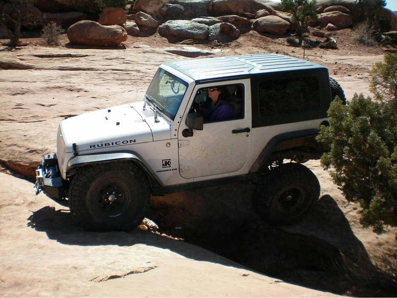

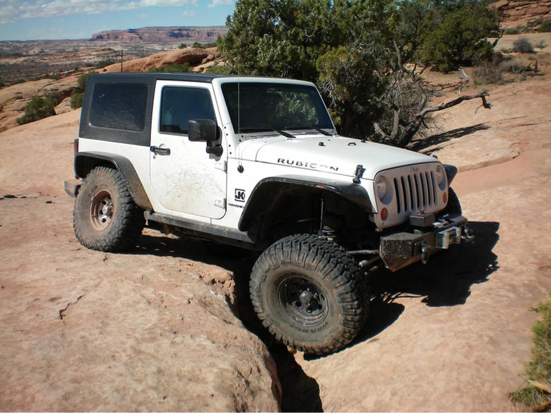

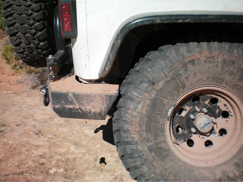

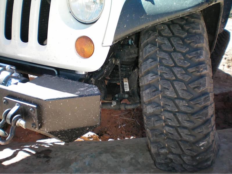

I'm talking about what you need for your suspension to fully articulate/flex out and completely compress the stock yellow bumpstops into the metal cups.
For example, here is my 2dr Rubi, back when it had 37s on 2.5" Teraflex coil spacer lift, 2.5" rear and 0" front extended bumpstops, flat flares, 1" body lift, and only the front pinch seam of the rear fender well was modified (folded over instead of trimmed).

It's to avoid tearing the fender off when you stuff the tire. Hell, I almost pull it off with 31's, can you imagine how it would react with another 2" of tire coming up into it?
