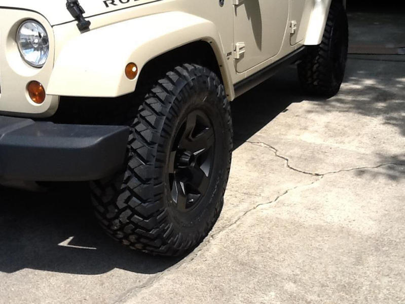

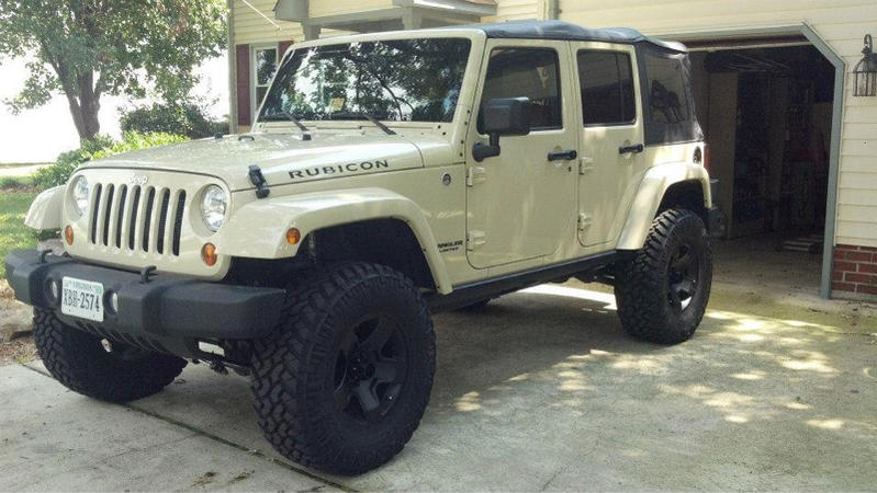

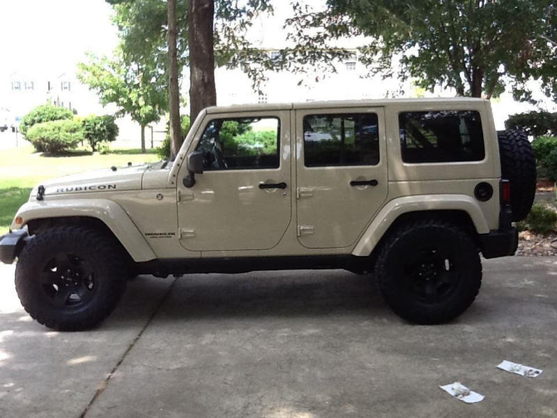

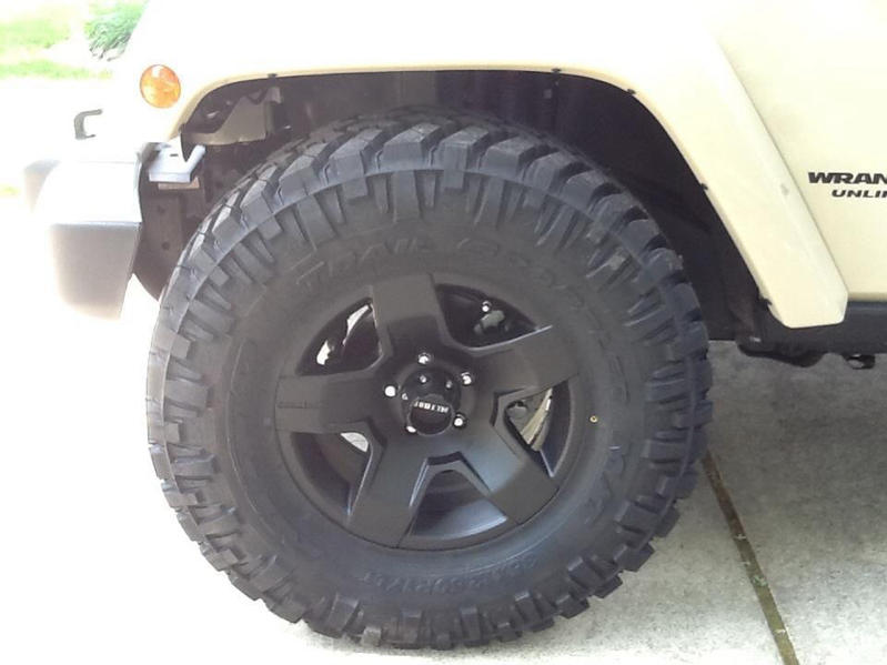

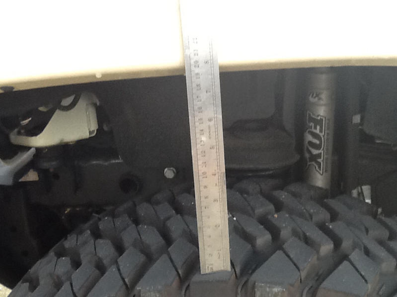

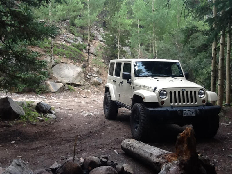

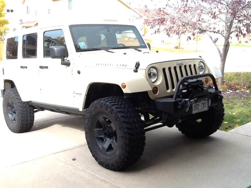

I tried and was ok for daily driving until I put passengers in the jeep or drove into an off camber parking lot. With cutting and spacers, you'll be ok bit not ideal for anything off road. You can do a budget boost which will help but you may still rub off road. Wheel spacers as well. I've attached pics of my rig with the same size you are asking about without a lift and with the lift.

Old Feb 28, 2014 | 08:02 AM

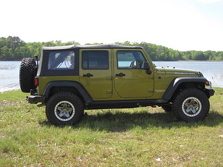

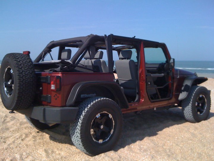

This is my '10 JKU sitting on 35's with stock suspension. I recommend flat fenders and watch your off-road use as you will be VERY limited on your jeeps ability to flex. As far as daily driving, did it in mine for a couple of years until I finally lifted it.
