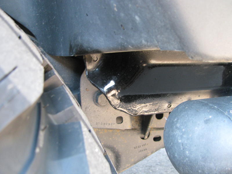

With 37's you're going to want to trim your pinch seams in the rear.
Attachment 268877
Forgot about that, thanks.
