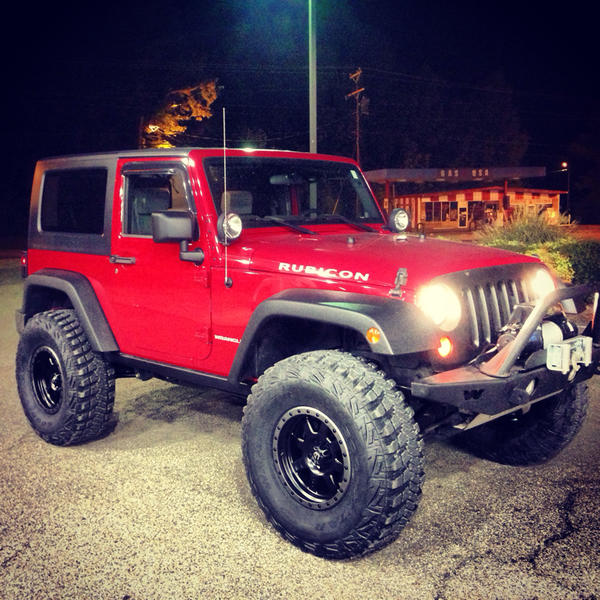

Are those RK 03100/03101 coils? (2.5" on 4 doors, 3.5" lift on 2 doors?)
Thanks. Here's mine with 3100/3101
