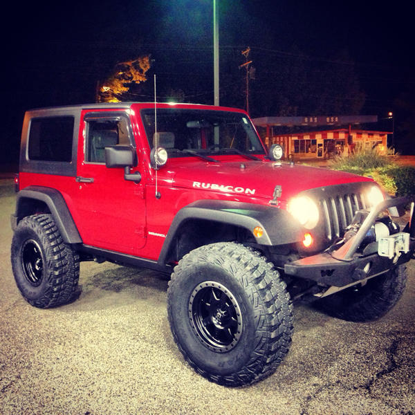

I did almost the same configuration with my 2012. I used the MetalCloak Game Changer 3.5 lift since it has a ton of travel and Trail Worthy Fab for my tires/wheels. All in all the Game Changer ran me about $4000, and the Wheels/Tires were about $2500 with shipping.
I use this as my daily driver now and love how it worked out for me. The MetalCloak lift is one of the best I have seen and always gets people excited to see how it works (The 6Pack Shocks are sweet.) The wheels and tires are double bead lock which according to Lift Laws | Suspension Lift Laws By State should be fine in your state especially since the ones from Trail Worthy Fab are Hummer wheels that are reworked to fit your vehicle.
I plan on doing more changes but for now my setup seems to be doing more than I hoped it would.
