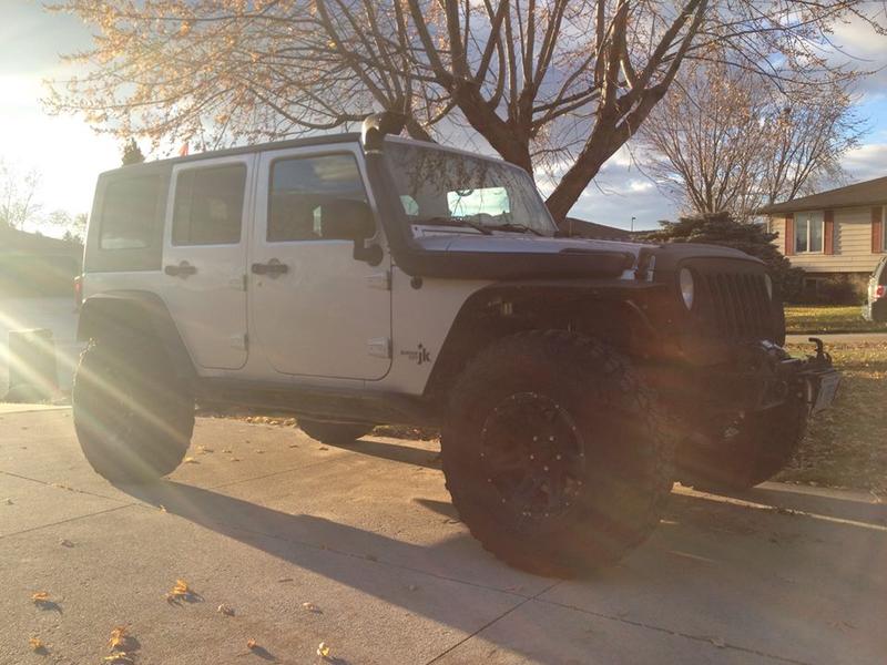

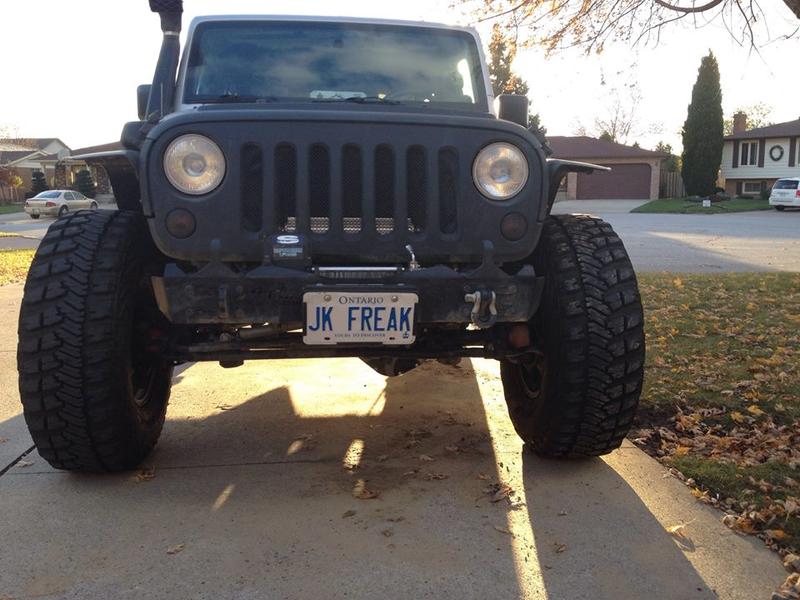

37's went on today
ID:	511069Click image for larger version
ID:	511070Click image for larger version
ID:	511071Click image for larger version
ID:	511072Click image for larger version
Old Nov 12, 2013 | 03:23 PM
  #39
Joe_B's Avatar
Posts: 656
From: Toronto, Ontario
Originally Posted by jeeperjkjeeper
Looks awesome. I ended up ordering the VKS sliders today...looking forward to getting them
Old Nov 12, 2013 | 03:52 PM
  #40
robsjeep9's Avatar
Posts: 3,802
From: Kitchener
37's went on today
<img src="https://www.jk-forum.com/forums/attachment.php?attachmentid=511069"/><img src="https://www.jk-forum.com/forums/attachment.php?attachmentid=511070"/><img src="https://www.jk-forum.com/forums/attachment.php?attachmentid=511071"/><img src="https://www.jk-forum.com/forums/attachment.php?attachmentid=511072"/><img src="https://www.jk-forum.com/forums/attachment.php?attachmentid=511073"/>
Looks good
ANY ISSUES WITH BALANCING those MTR's?
