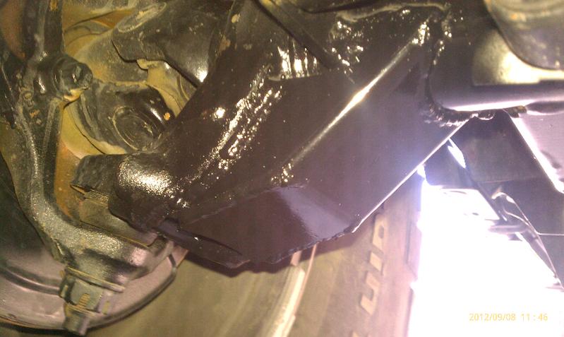

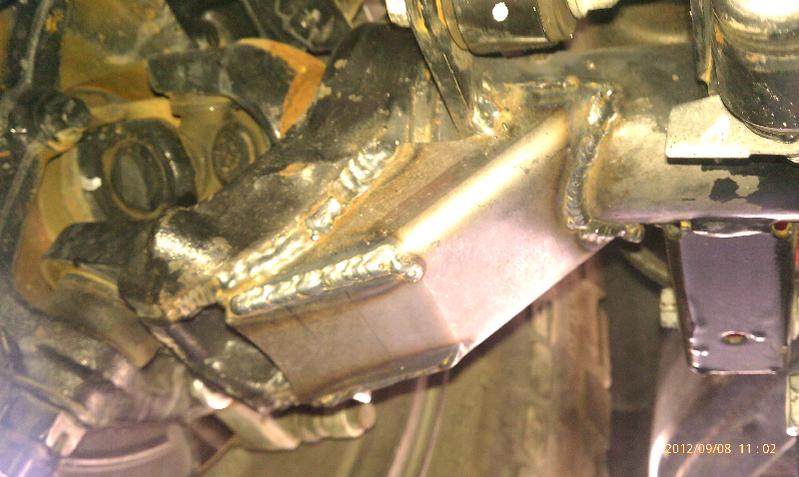

People do it that have 35's or 37's cuz the stock dana 44 front housing and outer C's are weak.. If u hit a pothole on the highway with 37's on u have a pretty Good chance that ur gonna bend or break something. So doing any hard wheeling on big rocks will even have a greater chance of doing this. There actually have been a few cases where someone's axle or outer c bent or broke with stock Rubicon bfg's. So installing sleeves and gussets will help prevent it but not bullet proof it. OFFROAD EVOLUTION sells both sleeves and gussets with full instructions on how to install them. They both require welding, the sleeves require removing front axle shafts and drilling half inch holes in the housing then install the sleeves and plug weld them to the housing. I just installed my gussets yesterday by myself but only took a couple of pics
