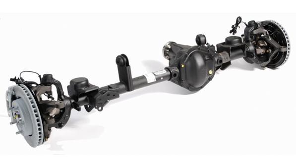

but when you upgrade from D30 to D44 is it a whole new Axle housing? As in, will I need to buy the entire component that converts the power from the drive shaft to the wheels and everything around it?
Or is upgrading to D44 only the inner axle shafts?
Also, If I re geared my D30 to say 5.13, Can I keep the gears if I upgrade to a D44?

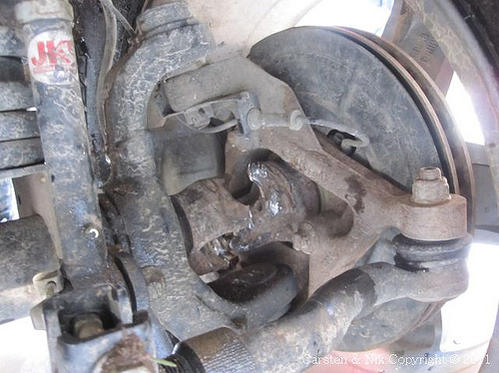

Just did that to mine a few weekends ago at Rausch Creek...it was a hell of a loud "pop!"

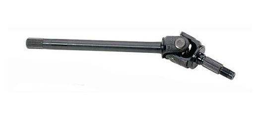

My stock D30 lasted two years with 5.13 gears and 37" MT/R Ks. Until last weekend when I grenaded the driver's side wheel u-joint and tore up the axle shaft. Time for a Dynatrac 44 from Northridge. My D30 will live on under my Comanche.

A D44 is an entirely new housing with different (read larger and stronger) internals.
Gears from a D30 will not work in a D44.
