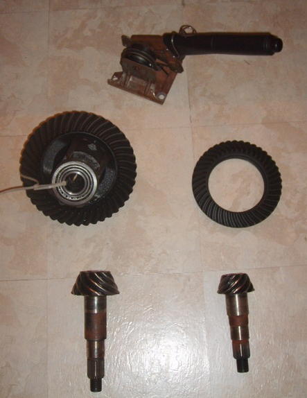

OK so i bought some d30/d44 4.10 gears. My question is will they bolt onto my carriers, having the whole swap go smooth on my 07 JK X. i have a D30/D44 setup myself. i heard i might need new carrier for the front bc of the carrier break? (whats that) i want the install to go smooth for who ever does it, and dont need a "the ring didnt fit the existing carrier....or axles wont fit...." just a direct swap.... HELP? anyone knowledgeable in this area. what do i need besides the overhaul kit.

The sticker said i had 3.21... (but also had lots of extras put in from dealer or whatev) and nothing else indicates that i do, so im guessing i have 3.21. When i bought the set, it came with the rear carrier. the stamps say 41 10. i tried looking up the BOM on the front axle (2007651-1) but cant find anything on it.
nthinuf - i heard the same about the swap.... but it was the early JK's. the Sahara came out with the 4.10 instead of 3.73 and the carriers were the same, but IDK. MY jeep is one of the first to come out. I bought in Feb 07, before i saw anyone with them on the road. My door locks dont even say "lock" or have the slant that the new ones have. mine is flush with the door panel. people even ask me "how do i lock it?" i have to tell the "it the circle next to the door handle"
i did consider 4.56, which is what i want now, but cant find a set. and Norther4x4 has a great deal on 4.88 gear set and overhaul kit for 550, but 4.88 seems high for 33's and do they simply just bolt on to existing carrier's i already have?

thats it exactly what i heard. the 7/16 and 1/2 bolts.... i noticed that the rings have dates.... d44 has a date of 02 09 06, and the d30 has 05 24 06.... the d44 takes a 3/4 socket and the d33 seems like a 7/16 hole. Like i said my jeep is an early jeep. I bought it Feb 07.
i think im going to sell these to someone who wants them as i changed my mind. I want 4.56 or 4.88 gears. do you know where i can find 4.56? and what comes standard on any aftermarket rings? 7/16 or 1/2? im sure 4.88 on 33's in fine....
